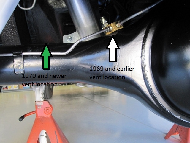

So I've come to the point in my restoration where I need to replace the brake lines. Of course nobody that I've tried makes a kit for the early A's (65 dart). I'm wondering what company people would recommend? I know there are going to be mods that I will have to make and that's to be expected but I would like a quality kit. I'm not sure what year my 8 3/4 is but I was told that certain years had the vent on the rear end housing in a different spot on the housing.

Right on guys thanks for that info. I knew there were 2 different locations on the vents but I couldn't remember the year cutoff. Ill get r done.
if you have a choice id put the vent on the axle tube and not the side of the center portion. it wont be as prone to seeping there.
