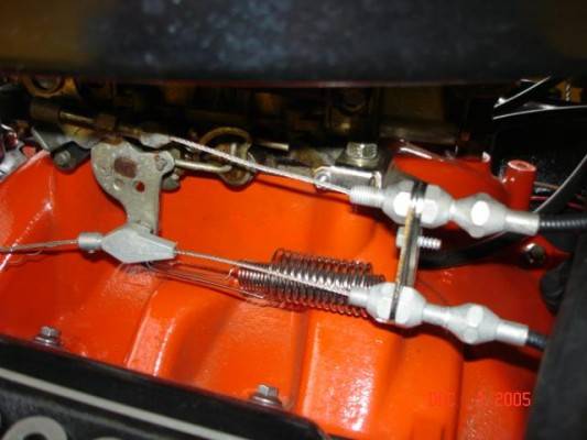

I bought the Lokar bracket and got a cheapo off eBay for around $20. I later realized you can use the same cable from a hardware or bike store (brake cable) and install a stopper on the end also available at the bike store. Trim with cutoff wheel and your golden.

Also just for the record, I made my own carb. side mounting bracket as the fancy one they sell also needs their brand throttle cable.

I'm running the Lokar cable with the stock throttle cable and real nice brackets from AR Engineering for the cables and the throttle return spring. Also made a bracket for a return spring for the tranny lever. It all works great. Holley 4bbl, 727.

While the Lokar is a nice kit finish and layout wise, it does add more resistance and takes a little extra effort to operate the throttle vs. the oem rod and bellcranks I've used
are you using an entire lokar kit? you know, throttle and kickdown cables , lokar brackets at the carb and return spring kit? or is it some Frankensteined together thing? if its all lokar you have something hooked up or run wrong if its harder to push the throttle down then a factory set up... every lokar set up i've ever installed operated smoother and has less resistance then a factory set up...
I believe you're right on that.
I was running a complete full Lokar, the throttle is also partly a fab job, with a long rod up to a bellcrank at the front of my van. With the KD disconnected, my throttle operated smooth and easy, when adding the KD it definitely required a little noticeable effort going full throttle. The KD was hooked up and routed correctly per the instructions. The kd lever length (the lever I was using was a little shorter in order to match the carb) and the spring in the valve body were likely (now with a clearer mind this morning) the reasons why it was slightly stiffer, not the cable. So I stand corrected. And as church lady said "never mind":BangHead:
