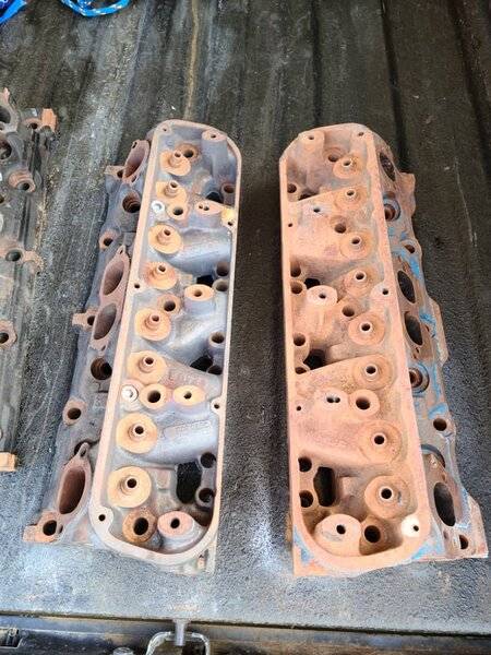

They are cracked in quite a few spots. Most most is on a bolt down corner but I have talked to a cylinder head shop in Kansas City that says they can repair them. These are also the aforementioned domed pistons I was talking about. TRW 4007042 pistons.
The first thing you should do is throw those heads in the closest scrap dumpster. Nobody in there right mind would try to weld a head with "multiple cracks" and a corner broken like that. They are probably just wanting to take a bunch of your money, for a head that WILL break as soon as you torque it down.

What’s the date code on those heads. I have a pair here for sale that are in very nice shape. Shipping is the killer but I’d bet the cost of welding and then machining them after all that heat would be more than the cost of the heads plus shipping.
never knew W2 heads had a date code on them, where should I look?
Realistically I only need one head because the one is the issue that has all of the cracks, the other is perfectly fine. One was store in the machine shop and the other got separated from it a long time ago and shoved in the back of an old barn where all of the damage occurred
You can probably tell which one got stored in which location LOL
The exhaust ports on the left head look like they have been ported on a bunch
Correct. One has been heavily ported, the other has not. My grandfather got them from his machinist friend that ran sprint cars. He started working on these back in the late 80s (before they went into my grandfathers possession) and ported one before deciding to move up to W8's (I believe?)

so you've got a head that needs welding to repair (and have to be lucky for it to last) and you still have to port it to match your other head. there's probably a reason that one head was tossed in the barn to rot away...
It got the damage from sitting there........
I think this is a bad rabbit to chase down the hole.
I did just find a singular 810 casting head for sale so I may be able to replace the bad head? As I stated it's just the one that has the damage
