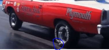

don't think any more need to be said but here is a snap shot of the problem.

We were running 16psi if his guage is accurate?.....against my thinking for a bias tyre but we'll go up until don't hook and adjust from there as suggested. Front adjustables are coming so that should help.......really should've had stiff walls from the off or radials, wasn't my call....yes that chirping sound is horrible.
Well apparently I have to work with whats on the car now, he's not going to change anything for the rest of the season so I'm up against it, he reckons he's got 5" travel but he don't get that the rate of rise its whats wrong and we cannot alter that with those 90/10's. So with that front end the way it will stay I don't know quite how I'm going to get it to stop unloading the tyres, any suggestions welcome from you guys?...currently we have the bars in the lower hole with 1 flat preload either side, shocks were on 5 (no rebound on 9-ways) and the car doing what it is.
Up the pressure to stop the tyre wadding is on, I guess all we can do is keep trying different preload/shock settings and not loading the converter as thats causing the car to rise further, running@the converter off idle will cause a harder hit so full stiff on ext. perhaps is the way to go.?

I agree tire is wading up, had the same problem when i installed caltracs on my dart, more air in the rear tires cured it. Took me forever to figure that out!
