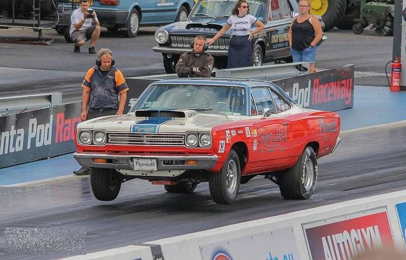

Your thoughts/comments on these launches

what I'd like to see is it carry the wheels a few inches not necessarily to the 60 but some ways while it stays on the tyre, wouldn't we all.......
I'd lower the start line RPM. The chassis reaction is already used up when the car launches. Here is a vid of my buddy's 69 RoadRunner, this launch was at 2300ish. Notice how smooth and controlled the suspension works.

Agreed, thats how it should be. I take your words on board. Both front/rear are smooth, unfortunately it looks like our lakewood 90/10's on the car are staying:( so we will stiffen up the rears/up the psi, leave just off idle so still have travel left and see. I've just bought some rear shock extensions if really needed. Don't know if we can sort it without stopping the front being so violent, cutting bump stops down may give us a bit more separation which may help, we'll try with what we have, Calvert say if it hooks and spins to soften shocks up 1 click@a time but thats assuming the front is good. A go pro should be fitted inside (I don't know anything about launch/shift/trap rpm) and on the rear susp I'm told so perhaps we will see whats going on better, after spending all that money, to not spend just a little more (even my money) on something as important as front control is making things hard, but it is what it is.....Also I note you leave@2300 with no body movement you must have a good converter and running 10.9's@123?.(around 550fwhp?)..our issue is@720ftlbs we need better equipment I think than whats on the car currently but none of it is my choice.....maybe next year?.
You can cut down the up travel bump stops to about 3/4 inch thick, that will give you as much front end travel as possible. Running tubes in the rear tires will stiffen up the side walls and help counter act the bounce on launch. Hoosiers are also very soft sidewall tires, I've had much better luck with stiff sidewall tires like Mickey Thompson or Phoenix.

Echoing what others have said, I would try more tire pressure first (its free). Also, if you can, lowering the rear by an inch or 2 might it might do the trick as well. My car never liked the tail end up high like that, but my friends Demon sits like that and runs great (granted he has SS springs, no Caltracs).

Well the front is staying as it is, supposed to have 5" of travel, we'll try lowering the car 1", rear suspension travel is all used up I think when he loads that verter as is most of the front, Calvert do 3 lengths shocks for different heights, stock, 1" higher, 1 lower, chances are we don't have the right ones....we can do something about the rears, I bought shock extensions, rims have screws now, I'll mess with it to see if we can stay on the tyre but it ain't gonna be easy, will have to use Saturday to tune as its quali but thats not the best and Sunday is elims (32 car NSS brkt field). Fighting the front all the time.
Well small improvement over weekend, so 16psi in tyres, softer on ext. 6....and caltracs just touching both sides, ran ok but then 2 flats preload that my mate wanted, think he's got it in his head about preload. 60 now down to 1.43's and best was a backing off 10.44@120 in comp on a 10.48 dial....best WOT mph was up to 127.5 on a 10.47, DA was good on Sunday. Want to get it as good as we can with that 950HP (830 carb)...then a Thumper 1050-ish Dom is on its way....and were around 30hp off of what the dyno threw out with open hdrs currently.

We got it working much better now, still not as I would like it but not killing the tyre so much, 16psi and its more one movement at the hit to the 60......1st round loser with a -0.012 red, 10.45 on a 10.44 dial today, other lane red lit too worse but he was a chaser and we did it 1st... but...
1.43/1.43/1.45 60's (shallow), 10.45/10.45/10 49 et's, bottom hole, 1 flat p/load, 7 hard on 9-ways, getting there slowly.
