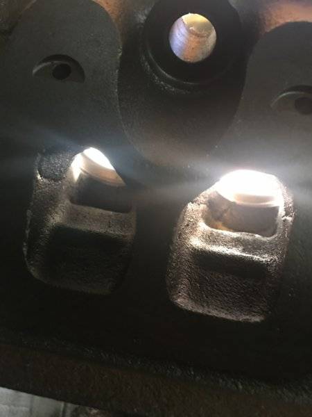

Not sure if this is the right place to post this, but here goes. Home porting a set of 302 castings. Can I eliminate this hump in the roof of the exhaust without finding water?
The set sure need some rounding/smoothing..............
Never done a 302 so i can't say. But that sure look like a lot of material to remove there. and why is it there. has to have some purpose! would have been way easier to have made the mold smooth there then add that bump, must has a reason, but i have no idea.
K, here is a couple question for you.
What is IN the combustion chamber? And, what is the Material that is in the exh port sealing off the air ports.(small holes that are drilled in the exh gasket surface that go into the port.

I have a set of 302's, that hump in the roof is in line with the freeze plugs on each end of the head. You could remove the plugs and look in there to get an idea of how thick it is, meaning - you would be looking into the water jacket at the top side of the ex. port roof.
