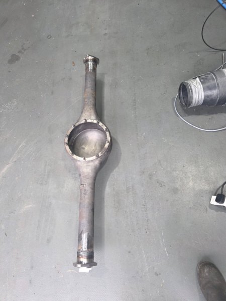

Diff is getting there all shortened and welded back together cant use off the shelf axles and cut so we are getting custom made axles to length. Then fit the ford disks which run the Mopar stud patern. Its my fault as told guy wasnt in a rush and to mechanics that means sit it in a corner and never touch it haha
Staying with the stock gears for now as they were good...... once its running will figure out correct gear. Running the trutrac centre

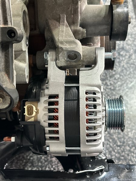

So the jeep 5.7 alternator works a treat for clearance but as we all know the set back is wrong. I will mill the back of the timing chain cover to bring it forward as only out of alignment by around 7mm. But the clearance to rail is great!! Especially when i bent the fold of the rail up
