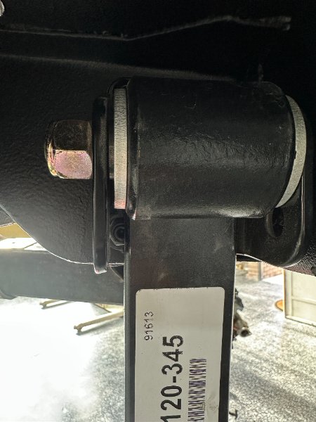

I have fitted the Dr Diff offset front leaf brackets with Calvert mono leafs, the mono leafs are a bit sloppy in the bracket as you can see from the photo. I think they are a little narrower than a standard leaf with a rubber.
Should i add shims or does the slop not matter? I cant tighten the nut any more as the bolt also acts like a spacer
In other news found a metal plater near me to plate all my suspension bolts and nuts that will be re used. Essentially will look like a brand new car. About to send a few items off for powder coating as well.
The bracket should tighten on the bushing inner sleeve.

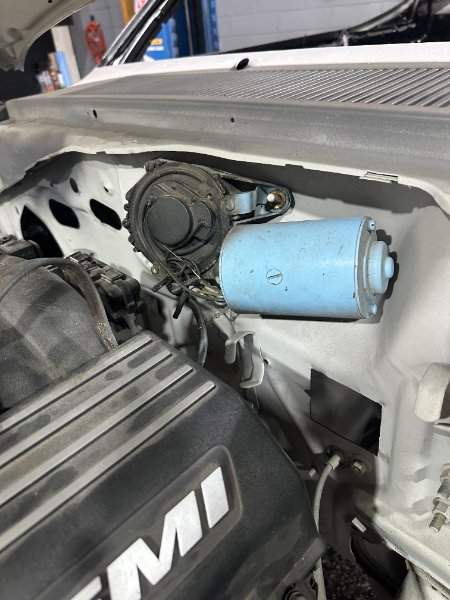

The windscreen wiper motor more than enough clearance! As again some guys have issues with this

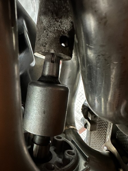

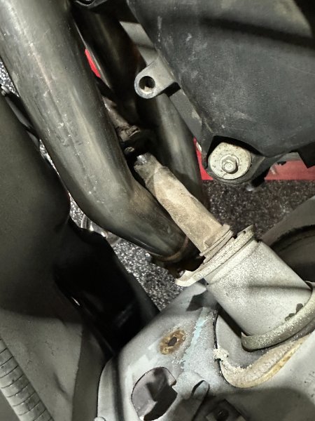

So the steering column has plenty of clearance and thankfully no cutting required to the tube. However i am using a manual PST steering box and adapter to go from manual box to power steering column but it still feels short. As seen in the pic below again will need to adjust pipe for clearance. I had to knock the steering column collar down the shaft to get the splines to be in correct positions for the lock pins to be inserted.
As you can see i am using the PST adapter but without knocking the collar down its short, however shouldn't the collar be in a fixed position on the original steering column? Or is it adjustable? Any ideas on better solutions or if i ahve done something wrong
The column body has a fair amount of adjustment. The bolts under the dash are slotted and the plate on the end that bolts to the firewall slide up and down. Could that make up the difference?
Can you slide the bottom of the column towards the center of the car to make more room for the shaft to pass that header tube?
Any issues with turning the wheel? The coupler is wider one way compared to the other and it might fit fine but crash when you spin it.
Yea the coupler tags the pipe but its like it needs to slide down the shaft closer to the box. Only other thought i had after research is if it has somehow colapsed? However thinking maybe use the flaming river coupler as gets rid of the fat coupler creating more space for the pipes etc

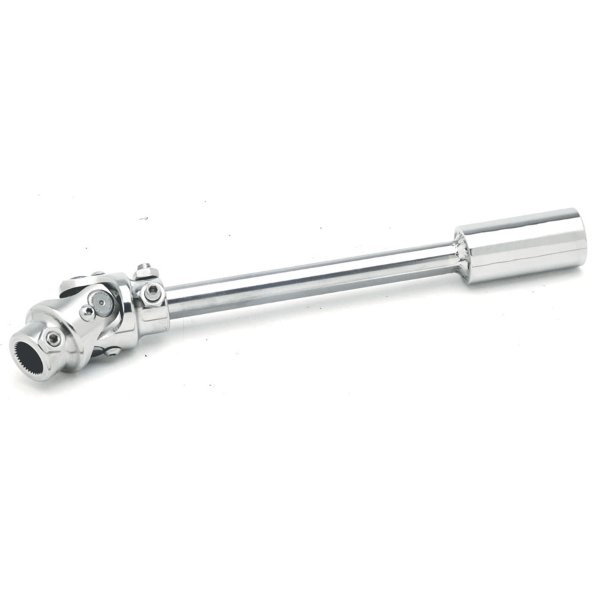

Anyone used one of these?
Never used one, but I am leary of anything that doesn't allow for chassis flex. The stock coupler has some in and out allowance that a straight up u-joint doesn't give.
There are sliding sections of shaft available and is the direction I plan to go if I go down the road of deleting the stock coupler.
The main issue i can see with the coupler is that its quite bulky and touches the pipes, a manual steering column would be lot better as coupler obviously much closer to the steering box.
By sliding sections of shaft do you mean you essentially making the shaft longer so no adapters required? Do you have a link to the items?
The stock coupler is built so the steering shaft moves inside the coupler some as the chassis flexes. If you remove that, there is no give and the shaft has to collapse or extend instead and it isn't intended to do that.
Steering shaft upgrade
Well i am a dud, once i fited my kaltracs she is right and tight lol, thankfully i purchased calvert leafs and kaltracs so all works in unison for fitment!! I really need to get one end of the car finished haha, currently a lot of balls in the air with this thing
