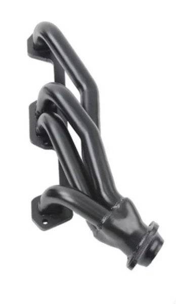

Don't know whether I can contribute to the thread but I remember the topic about manifolds/headers for a turbo application from a few threads...
I do remember that people were building the hot side using these: 94-04 Dodge Ram Durango Dakota 5.2/5.9 V8 S/S Racing Manifold Header Exhaust | eBay
Thinking about it they might be mighty tight in an early Valiant though...

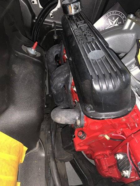

yeah it works for the drivers side but the passenger side is a hard no with inner fenders unfortunately, these early a bodies are cool but there’s no damn room! Lol

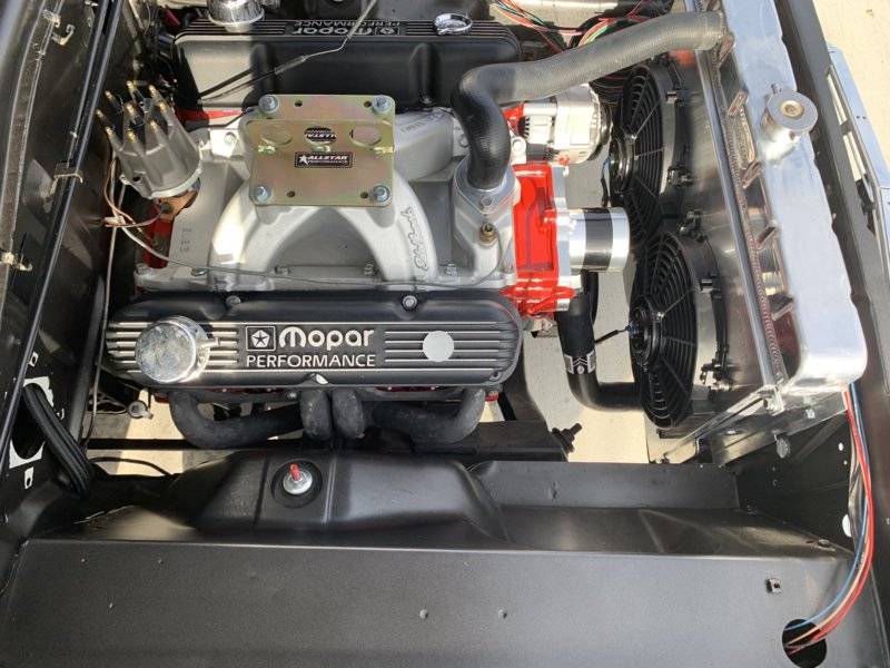

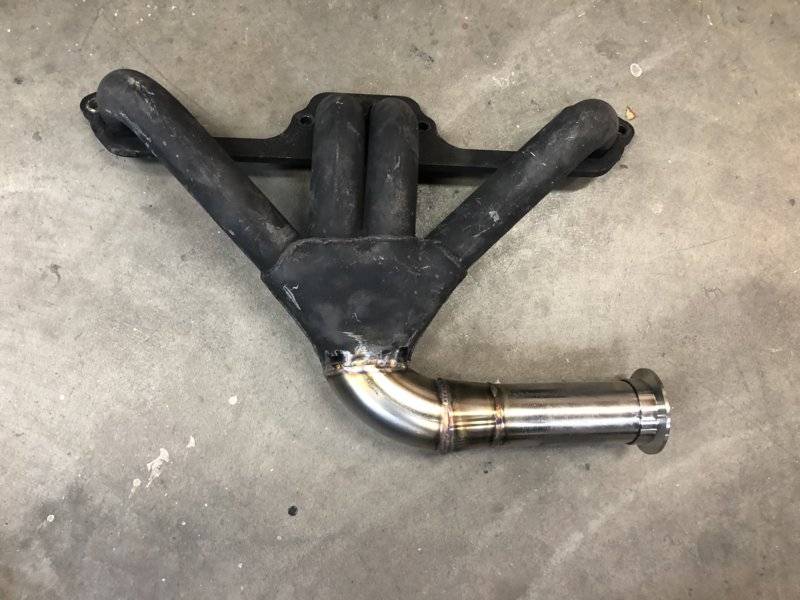

I was gonna end up using an original 273 passenger center exit manifold and a mid 90’s Jeep Cherokee manifold. There’s actually about a half inch difference. I’m back to a Dakota header for the drivers side and a Headman block hugger for the passenger side at this point.
I don't think the latter is a bad option. In fact, probably a pretty good one.
I like that idea. Really curious to see how the block hugger works out.

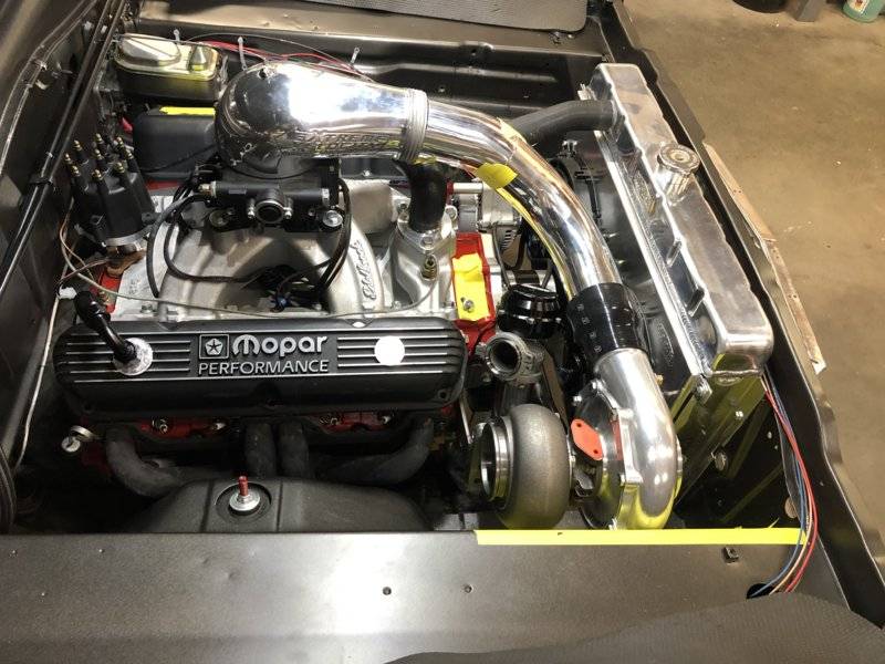

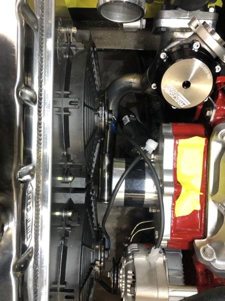

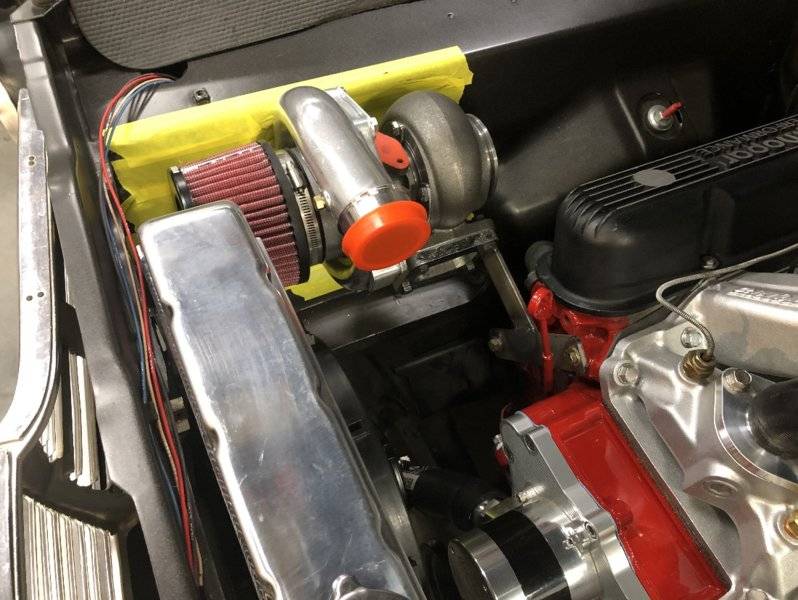

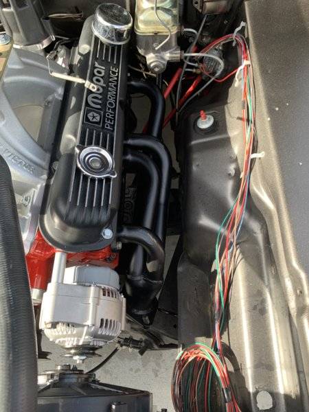

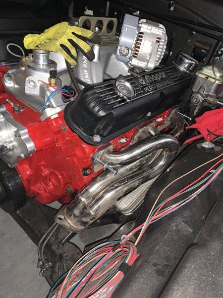

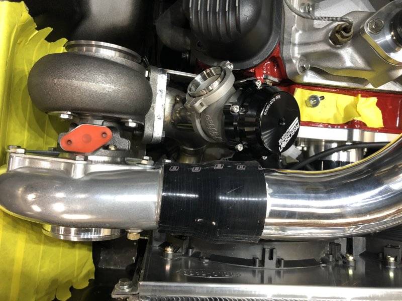

The block hugger fits really nice, I do have to pull the valve cover to remove or install it but once it’s on it is sitting right where I want it. I also ordered a pair of pacesetter headers for the magnum engines because it doesn’t have that ugly loop (I’m a little OCD I know). After Thanksgiving I will be moving it to my friends house to get some real progress on the turbo mount, hotside and such possibly installing an A/W intercooler also.

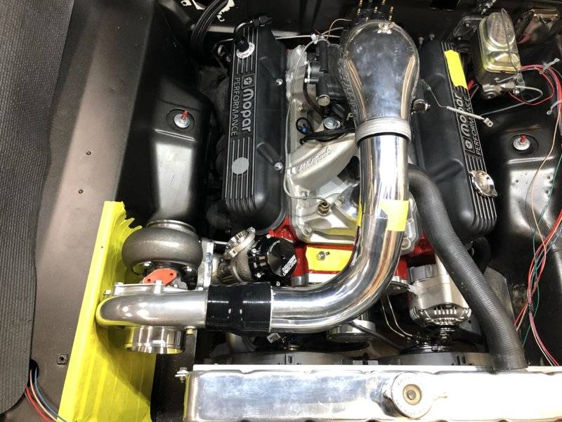

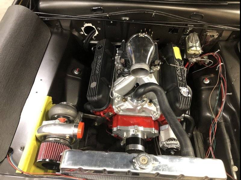

Making progress!!! Super excited how it’s turning out!!! At this point it’s mostly all mocked up and tacked. Hotside is all done in 2” stainless steel, used a pacesetter “Passenger” header on the drivers side and a headman block hugger on the passenger side. Exhaust is gonna be 3” stainless to about the frame rail on the passenger side then will go to a mild steel and possibly down to a 2.5 to get by the T-bar. Any opinions? Is 2.5 too small?

eventually it will get a HDK front end. My first goal is to get it back on the road and enjoy it a little. I haven’t been behind the wheel for way too long. Lol. Just a suggestion, twins would probably be easier to pull off.
Can you tell me why so on the Twins, is it the plumbing?
After talking with someone else recently they had me leaning towards a Single PT88 and says the "Precisions have a smaller footprint".
