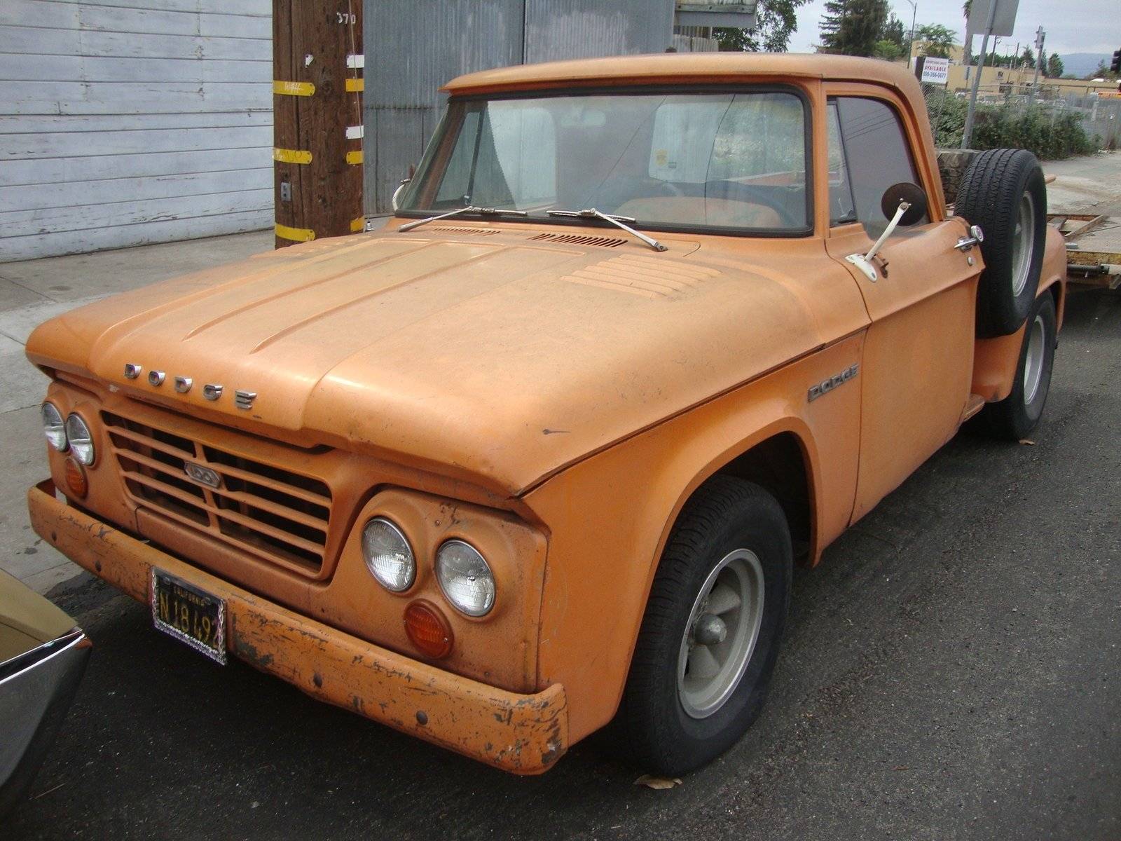

Budget D100 360 Suggestions

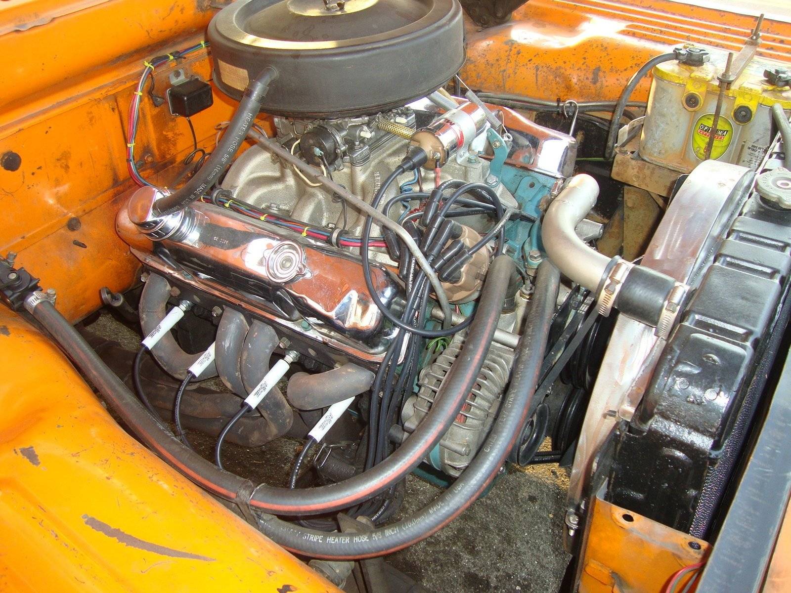

that 360 will run great in that truck , just mild warm it up , like the cop car motor . don't forget that you must use the 360 counter weight on your conv , yes on the 600 to 650 carb , afb or avs from a 340 works great and an intake . just went 383 on mine , been working out the extra heat issues . remember more horse power more heat more radiator . just did a 5 hundred dollar core and new fan n clutch for it and built a shroud . napa motorhome hd fan clutch .
A valve job, rings, bearings oil pump and gasket kit will cost more than a good running used magnum and will not make nearly as much power.
If you have a used 360 LA... Just clone the 78 E58 360 cop car/Lil Red Express pickup engine combo (true dual exhaust,headers would be nice..A good dual plane manifold( Eddy Performer,stock cast iron four barrel-340 manifold would rock here.. stock converter? Recommend Sum K6900 cam and lifter kit. Used several of this grind style in smog legal 5.0 mustang builds,and is a safe cam choice..I would recommend a stock style 340 spring,for a new replacement..318willrun,has it listed in his low buck thread..
Yea..another low buck armchair engine builder post.. If you didn't have an LA core,I would 5.2/5.9 Magnum it.....

Well, we've been gathering some parts. So far, besides the 360, we've got the proper b&m flex plate in route as well as a performer RPM intake, a 80457S Holley 600 vac sec carb, new timing set, orange box and electronic distributor. All he needs now is a decent cam and lifters and the appropriate valve springs.
Pretty sure this combo will outperform the stock tired 318 2bbl by a long shot. Thanks again for the input guys.
