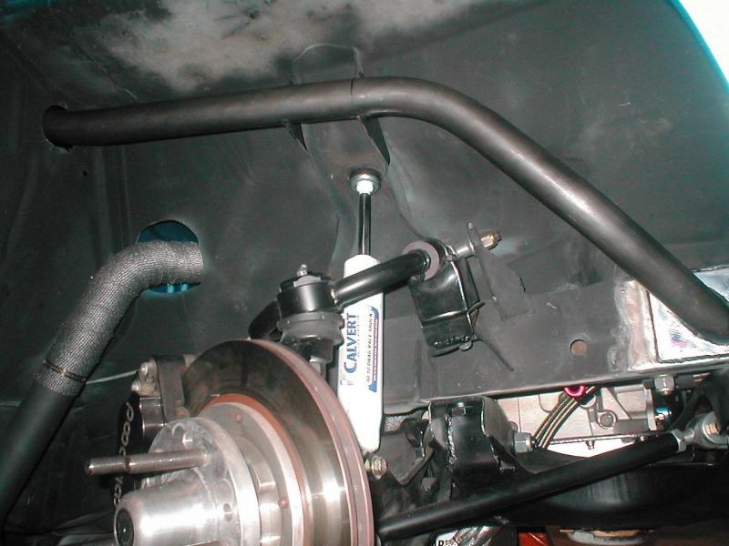

I am gonna run the AFCO 3850M DA shocks and I have the snout bars in engine bay to tie into the upper mount! the spherical bearing on the AFCO is 1/2" bolt and 1.06 wide.
attachment.php
does anyone here make a brace like this?
