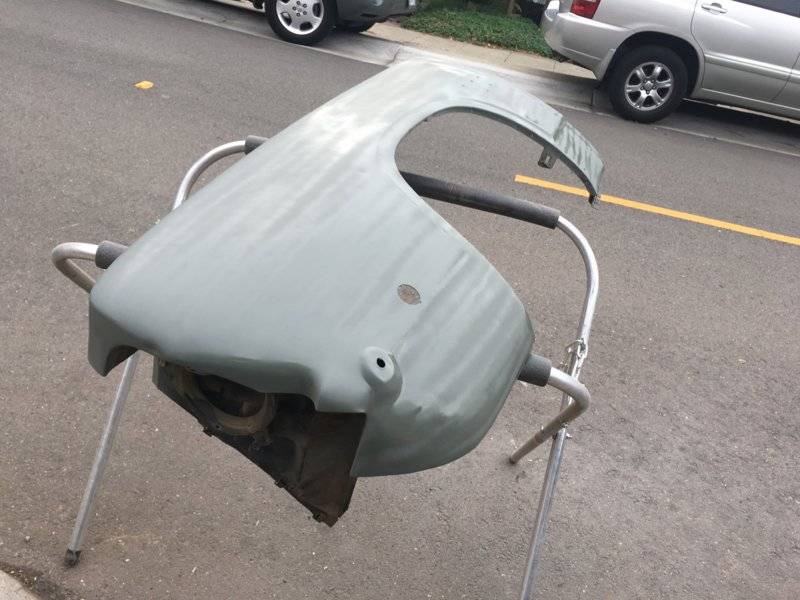

Update on first panel painted. Hood has been sanded at 220, 320 epoxy primered rattle can, wet sanded 400 then Rust-Oleum blues two coats, then 3 coats of rattle can 2k clear coat. Thoughts everyone? Should I continue with the rest of the car?
Looks really good kid!! Nice work thats a hard job to pull off with rattle cans id say you did it tho!! Looks good enough to be a head turner. Me and buddy always called those type cars 30 footers. They look amazing from 30 feet away. Lol

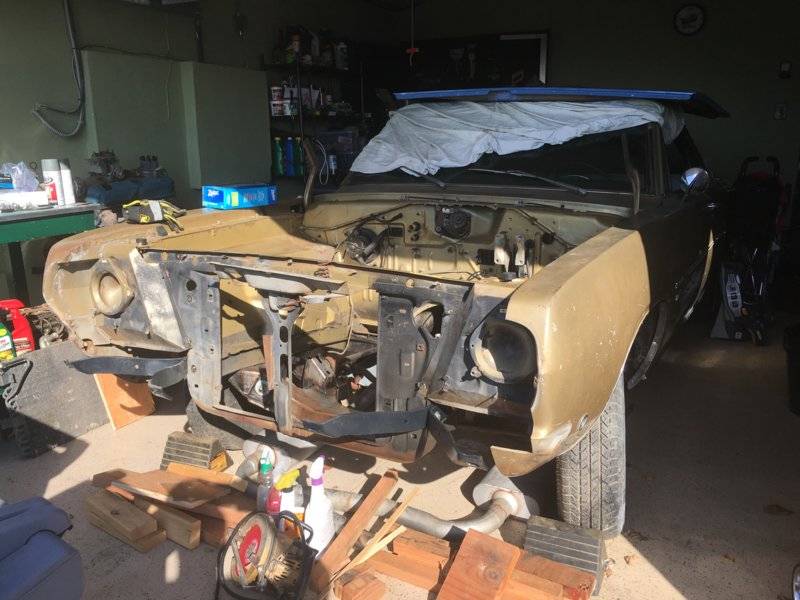

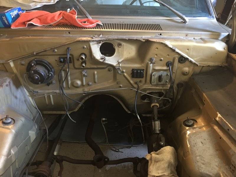

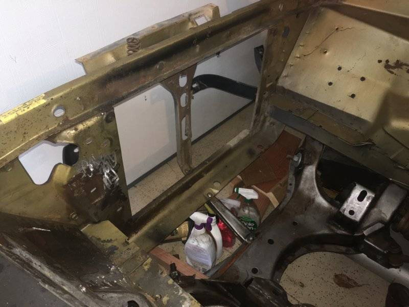

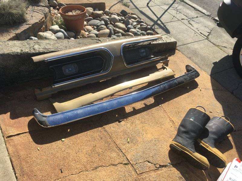

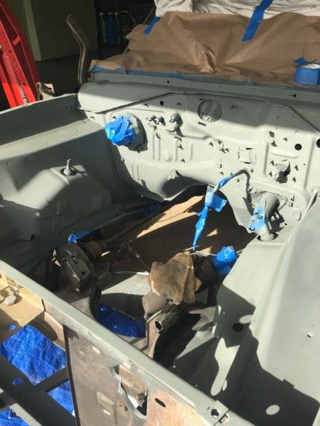

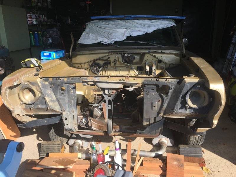

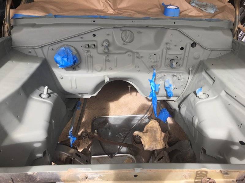

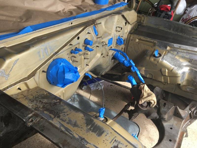

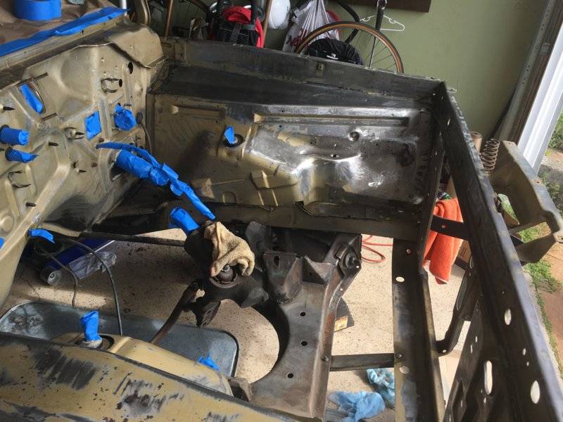

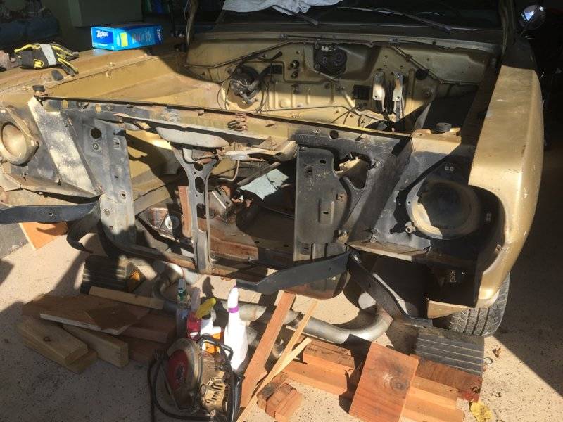

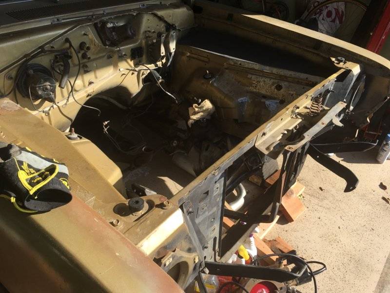

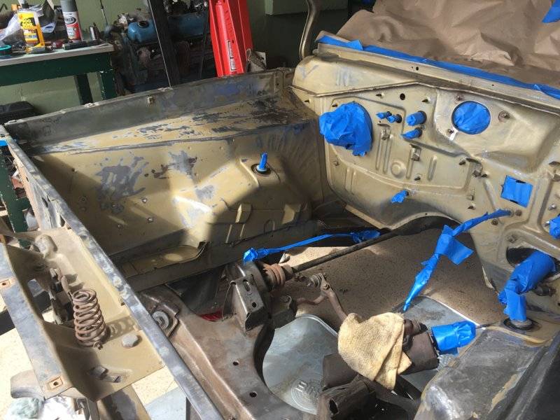

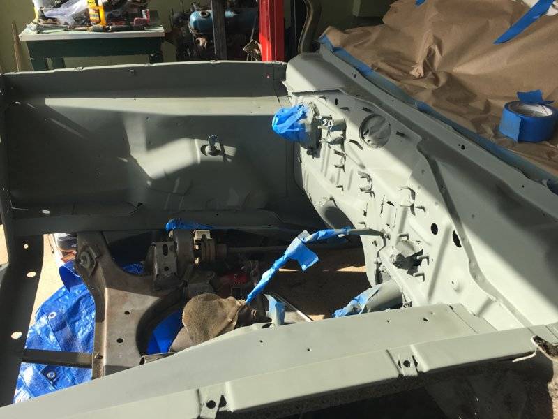

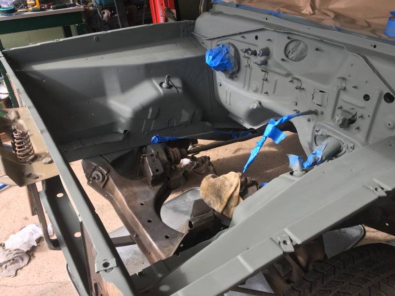

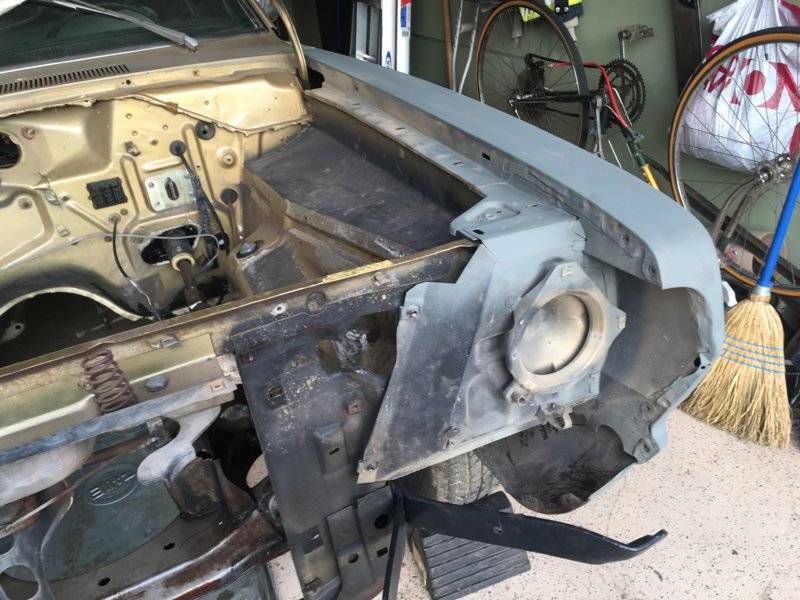

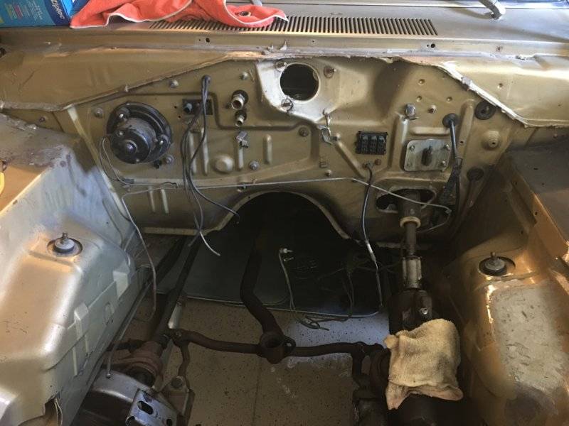

I am stripping down the front end to paint the engine bay and K frame and fenders. These are Pre pictures for documentation purposes.

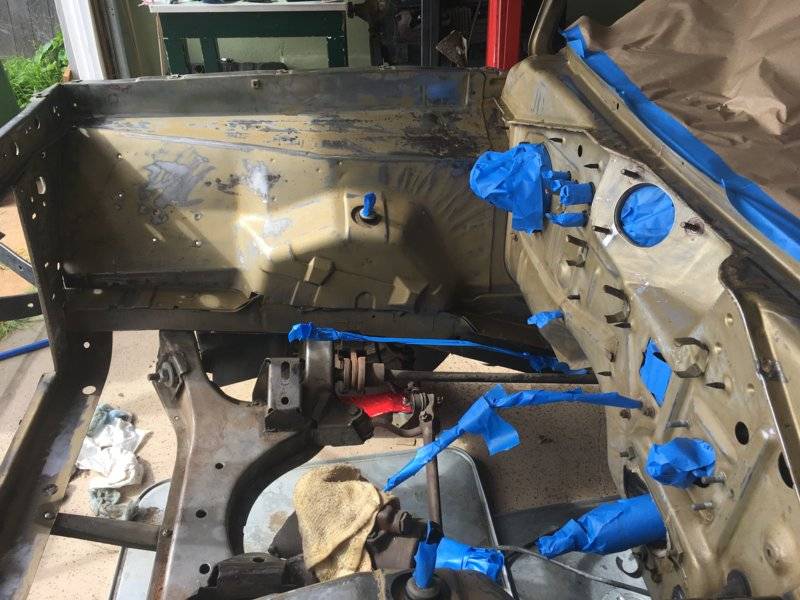

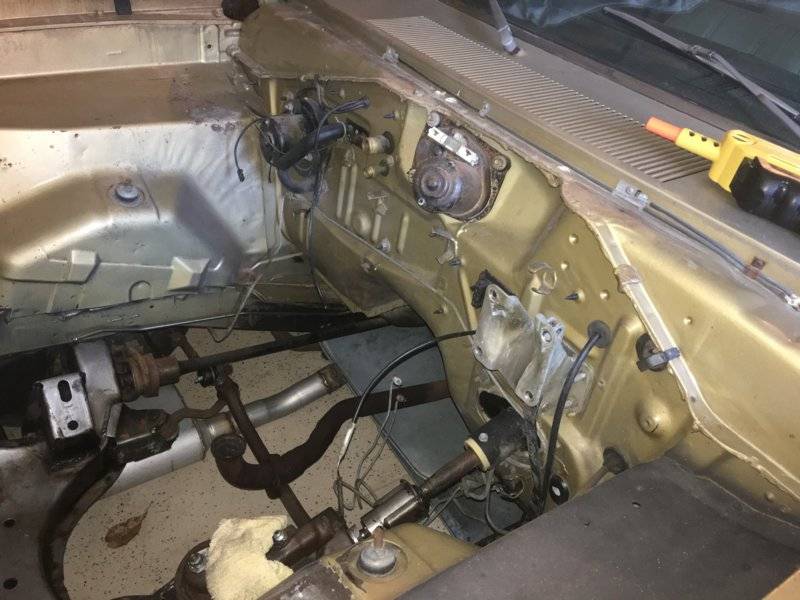

Pulled the brake booster bracket and wiper motor as well. trying to not have to tape off as much as possible.

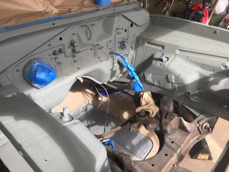

Lots of little nooks and crannies to clean and scuff. Better the prep, nicer end result.
I’ll hopefully have more pictures of progress this weekend. Just a little elbow grease!

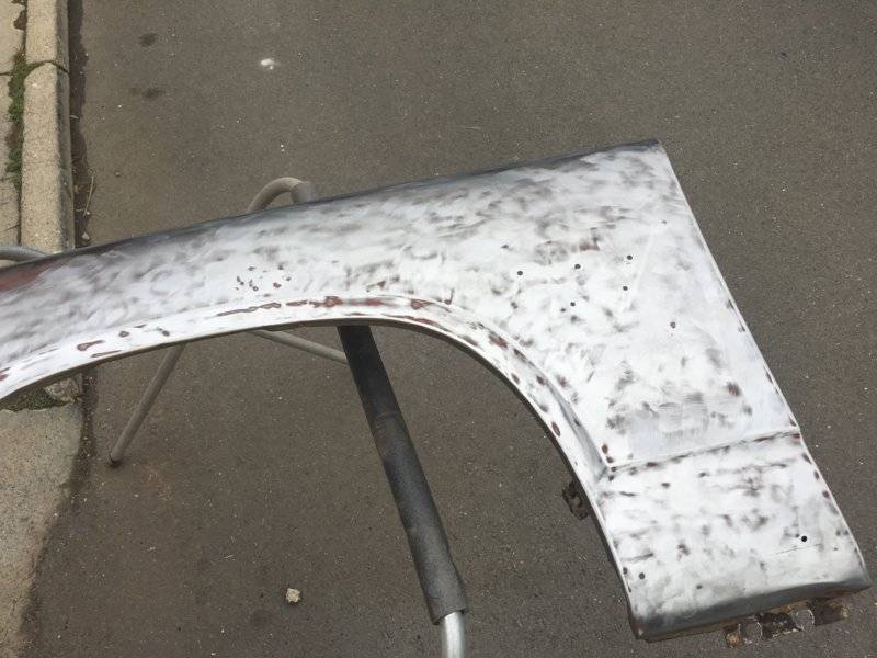

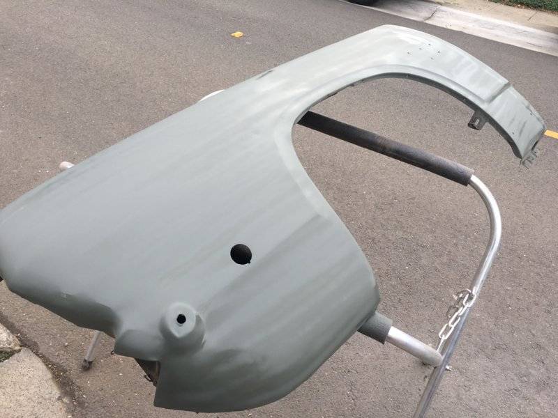

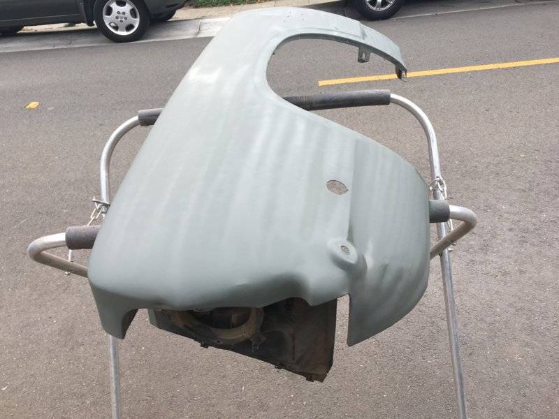

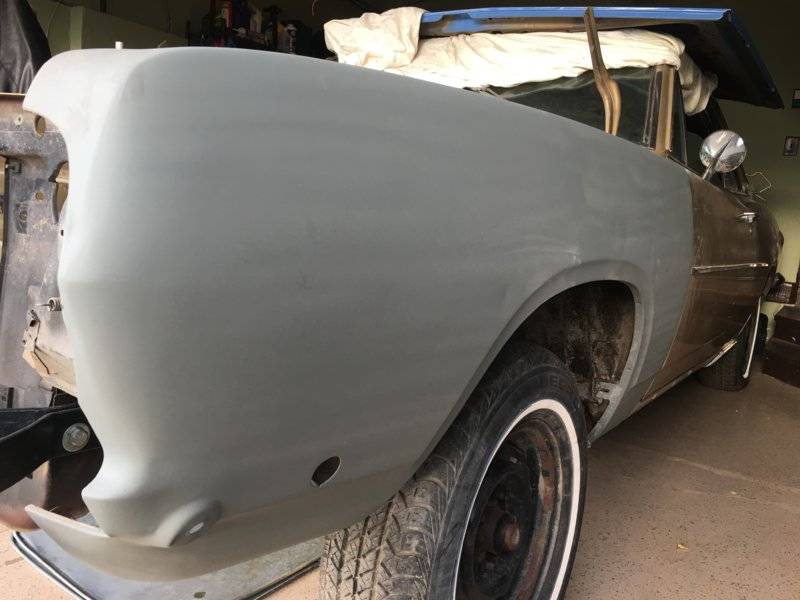

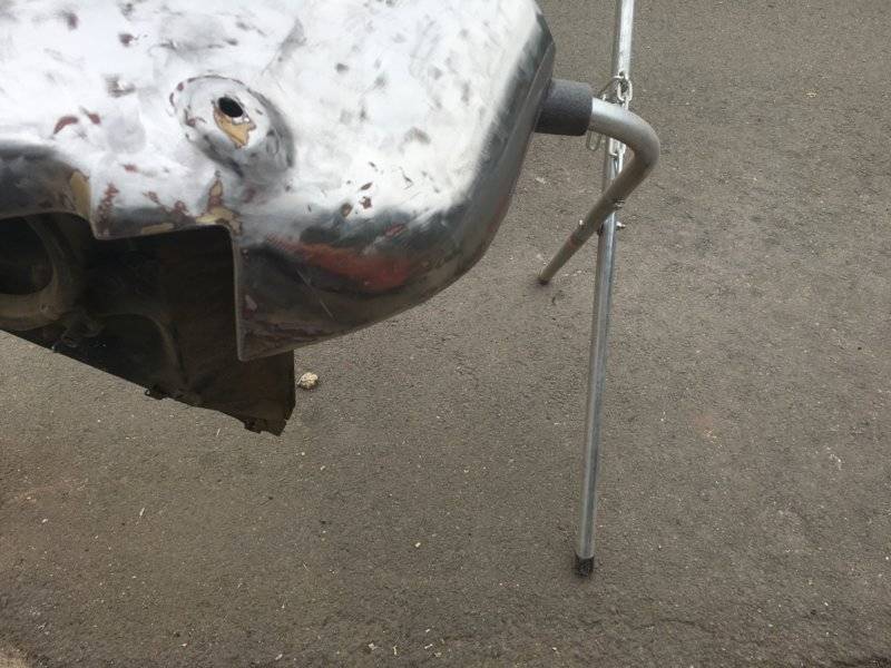

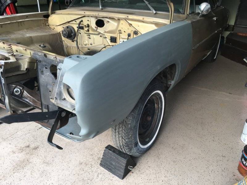

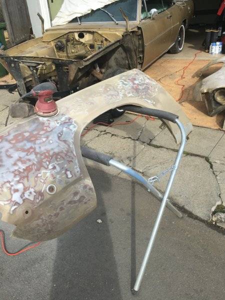

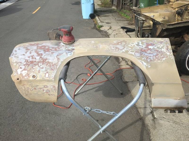

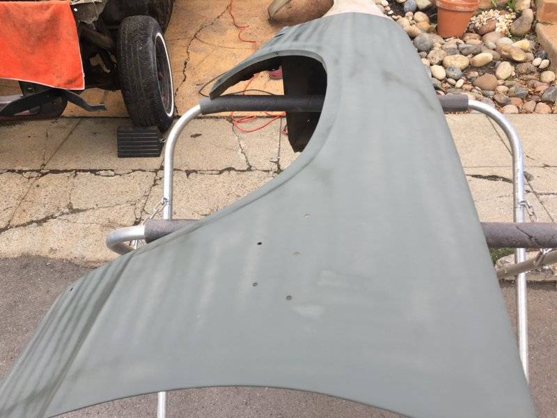

Well not as far along as I thought I’d get. Sanded down the driver side fender to bare metal. Sprayed self etching primer. That is all.

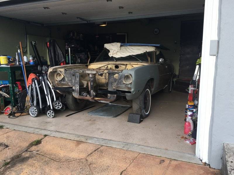

Looking good. Are you painting in the street and who's cars are those?
The cars in the background are neighbors cars as well as my own. And yes this far I’ve been painting outside on the steeet. That may change soon. I may start painting inside my garage although very little room to do so.
10 footer and rattle cans using the OEM paint as a base? Don't sweat the dents. Just rough it up and spray.
Ok, you're just killing me. I used to paint locomotives and cars and boats and anything else that came my way. You are doing all hard work, the cleaning, the prepping, the sanding and taping. All of it and it looks like you're doing a really good job of it. And then you're using spray cans? I'm not knocking the work you're doing but seriously, shooting paint with a gun isn't that hard and with a little practice most people can do a pretty good job. I gotta believe spray cans are going cost you a lot more than shooting it with a gun and even a half ways decent paint job will look a lot better than the best spray can job. I would like to make a couple suggestions. When shooting your panels and smaller areas you should tape them off from other areas of the car so that they can be sprayed individually. That will help you from getting dry spots and tiger striping. When you do the roof it also would help to have one person on each side spraying at the same time to keep the dry spots to a minimum. As for spray cans, I use them a lot and they can produce a super finish but on smaller items only. I've tried it with spray cans also. Just trying to help with my past experience. Good luck. It truly looks like you're getting the best job out of those spray cans that you could expect.
