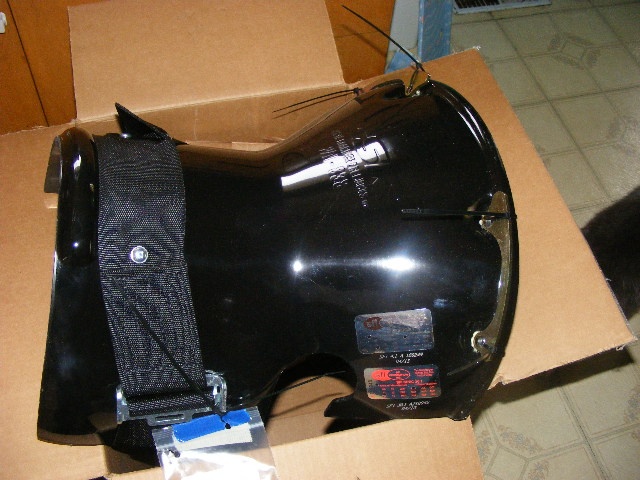

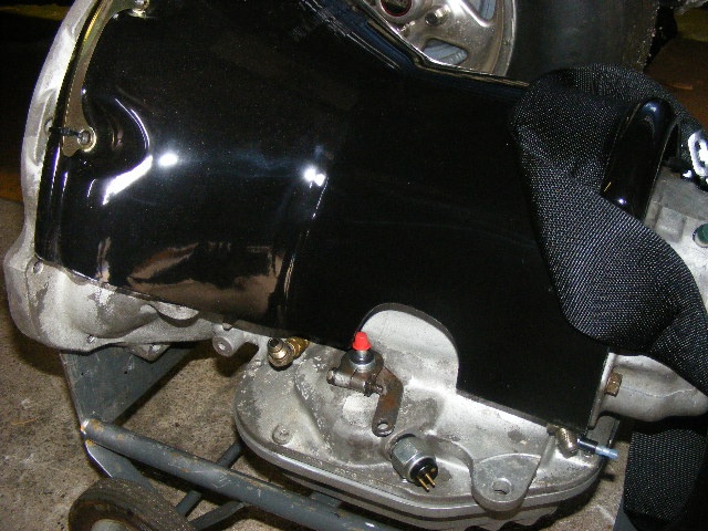

My 67 has room, but I had to pull the trans cross-member and lower it a little to get it in. It is snug, but the blanket will fit....then just put the trans back in place and re-install the cross-member.
the CSR supershield fits the tunnel like a glove....Got another one to install on a 904 later next week....gotta cut a few mounts off the trans for the shield to fit.
