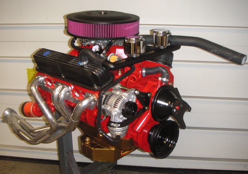

I've been selling the bracket kits for the 60A Denso alternator for years now. Lots of people have used that kit to install the Toyota alternator onto a SB, BB or Hemi engine. Seems to work great. I've had a 60A Denso on my Coronet for a long time as have most of the Mopar guys I know.

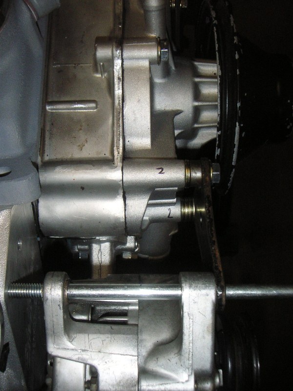

Well, finally did the denso 90 amp alternator swap on my 65 barracuda with stock brackets and cast iron waterpump. Had been putting it off for years and now its done. Didn't have to change the belt just extended the adjustment arm out about 3 inches with a fabricated extension. Belt lines up too. Went to the squareback alt and upgraded the regulator at the same time years ago. Works great. No more fluctuating headlights at idle and electronic ignition dropping out at low rpm. would highly recommend this upgrade.

After extensive research I used a o'reilly part #13220 for 88-89 dodge trucks and vans. Only thing I had to do was to grind down the ear closest to the pulley a little, enough to fit the stock bracket, wire it up, set the belt tension, extend my adjuster for the belt tension. I know it looks close to the exaust manifold but there is 1/2 clearance near the manifold. I trimed the little stud which holds the guard in place with my dremel tool so that I could rotate it away from the exaust manifold. Been running it like that for the last 2 weeks in this summer heat with no issues. It recovers from starting very quickly. I did not bypass the amp meter. I just cleaned all the connections from the alt, back thru the firewall, to the battery stud. I added a 80 amp maxi fuse along with the appropriate size wire which I got from Summit Racing from the alt to the battery stud. The amp meter is no longer accurate now so I added a volt meter to monitor it. I switched to the dual field alt and voltage regulator years ago. I just added the alt to finish the upgrade.
