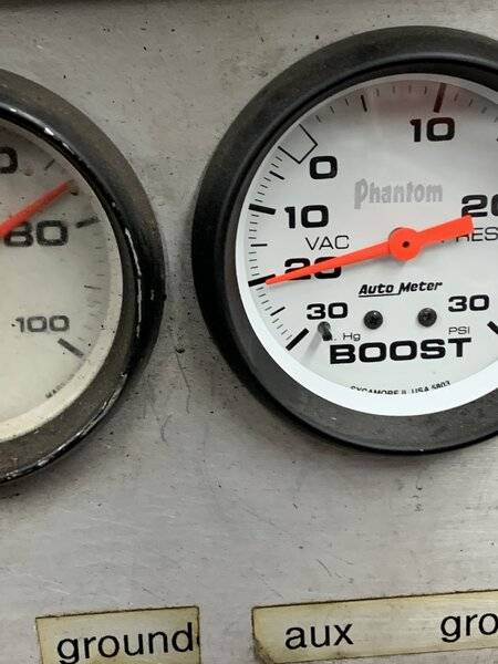

Okay it’s on the Dyno…. We will spin it Wednesday evening… let the horse power torque guessing being….
