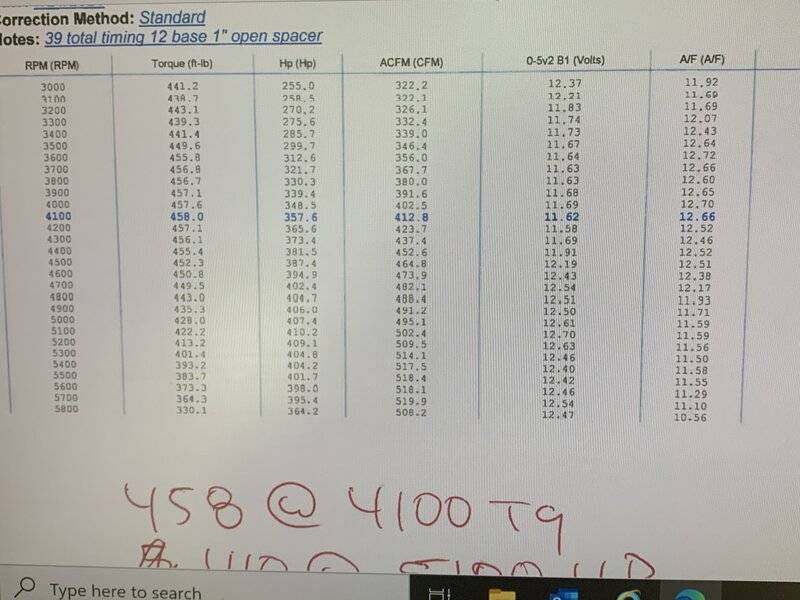

I just looked at the time line on the dyno sheets…after a 5 minute warm up the first pull was at 6:14pm and the last one was at 6:32pm…that was 5 pulls in 18 minutes…carb spacer install between pull 3 and 4 took 7 minutes…pull 3 made 400.9hp with no spacer

Here is pull 3 with no spacer
Last pull with all information for those who are interested in this sort of thing…
Judging by the AFR there’s more in it. Probably another 10-15hp or so

Another local engine shop had a 340 with 10.5 comp and a bigger cam on the same dyno recently…. It made 415hp at over 6000 and a lot less torque… a part of me want to stuff more timing in the magnum and jet the carb until it went 416….but that would be just for ego and that’s not my thing

I’ve never run the EQs but I can’t imagine that chamber wanting as much timing as you put in to it or even more. It’s hard to argue with results though. I’ve seen the best power at 36deg on closed chamber magnum stuff.

The pistons are 50 down the hole....the thing is likely not even 9:1...I bet I could have put 42 degrees in it
