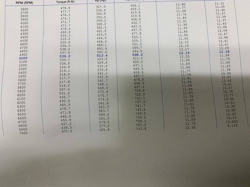

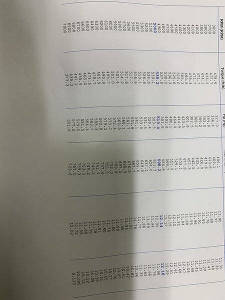

Thanks, always interesting. It really tanks @ 7000rpm or maybe the throttle was slammed closed at the end of the test. J.R.
Here is the cam card….because I know you like that sort of info….
It had a Holley strip dominator intake on it…they figured to get to 600 it would need to be ported
