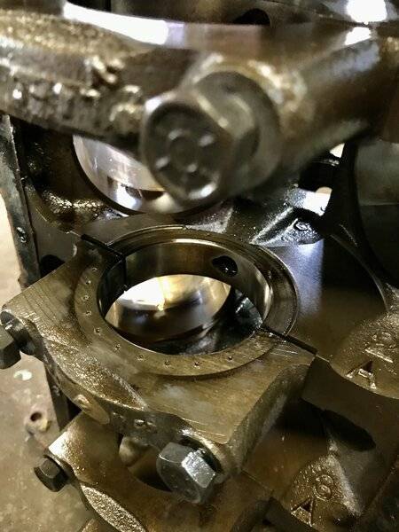

So I’m tearing down my 76 360 which came out of a Cordoba.
I don’t think it’s ever been apart, but there are a few things I haven’t seen, or am unfamiliar with
First off is the thrust bearing caps, they seem to have punch marks around the edges. Is this a normal thing?
Also, it seems that half the connecting rods on the left bank, have a bronze colour to them, while the others don’t.
Also some of the rods seem to have oiling notches on them, the others don’t..
I just want to make sure I’m not missing anything. Should I just get new rods from summit which already have the arp bolts?

In the machine shop we used to use a punch to put punch marks on a surface that we wanted to expand, in your case to decrease the amount of thrust end play??? In this case it's not the right way to correct for excessive thrust!!
That’s exactly what I was thinking too!
I didn’t think this engine had been apart before, but maybe I was wrong??
I agree with tightening up for a too thin cap. Or bearing that is loose on cap.
Not something the factory would do.
Maybe a dealer mechanic.
Look at the bearings for manufacture markings. Not sure what the factory used but I don’t believe that they had names stamped on them. I could be wrong.
The copper color comes from the heat treatment done on the rods... sometimes they remove it sometimes not. I have 340 rods that are a mix that came from the same engine. No worries.
Some will say the copper was a plating that fixes mis-machined parts. Not so...
Factory bearing shells will usually have FM (Federal-Mogul) and the bearing size on the back of the shell.

Should I be concerned about the bearing caps, Should I use different ones? I’ve never seen one with punch holes like that

@Mopardan74 I don’t see any reason not to run it. Getting new caps introduces a good bit more of expenditure that is t needed. As long as the cap does it’s job, use it. Those dimples do nothing against the cap.

Could you post some more pictures of that #3 main cap. Even thou it has a #3 on it, it does not appear to be an actual thrust cap, it looks more like a cap used in position 1,2 or 4, I don't see the under cut machining of the cap for a thrust bearing!
