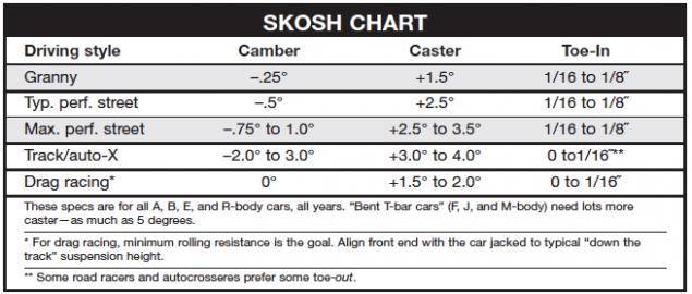

New aligment specs.. still feels vague
the car tracks straight and drives ok but just not as planted as it could be. Before my engine change it was really stable and heavier feeling.
As for the camber I was thinking we had -.5... I see now its a +.5... My bad.
I will try for -.5 or more and maybe 3.0 caster and see how it drives.

I used the Skosh chart Street Performance specs..
I will try the Max Perf. specs and see what that gets me.
Well, no you didn't exactly. What the guys are telling you is that camber should be NEGATIVE as in this chart, that is with the tops of the tires tilted in. I would want more caster if you can get it.

I shoot for .5*negative camber, and as much caster as I can get which usually ain't much on a stock A. With modern equipment,and working cams, getting the camber balanced is relatively easy.
Sometimes, depending on application, it is better to sacrifice a little camber to get a little caster. But in your case the tech went to +.5 to get 2.7, and IMO that ain't right, and once you get the car leveled front to rear, that 2.7 is gonna shrink. So I highly recommend the Moog problem-solver bushings.

More positive caster and more negative camber should give a heavier feel. That’s mostly the caster. The negative camber will help the car feel more planted though.
If you lower the front you’ll gain some negative camber with the lowered suspension geometry. As AJ pointed out you’ll lose some positive caster. But if you have the offset bushings you should be able to get +3 to +3.5 for caster. Some people have gotten more, but it depends on ride height and other factors too.
