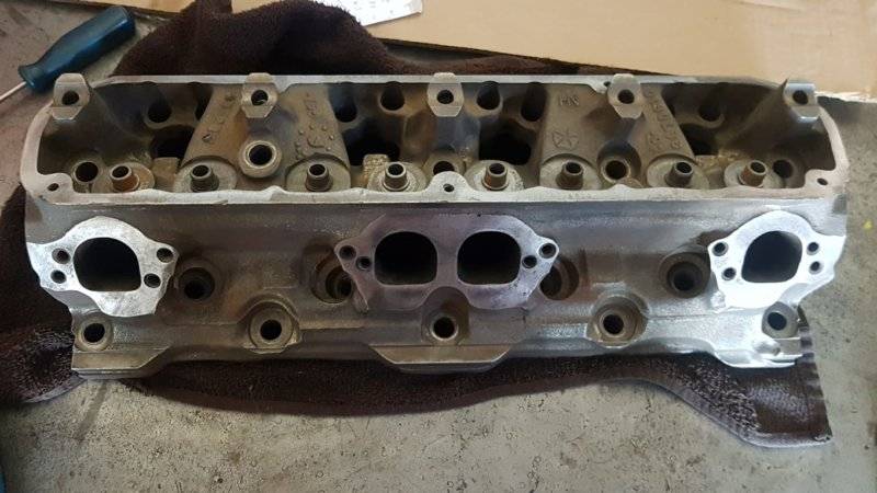

One word of caution, when you assemble them make sure the bottom of the rocker doesn't hit the spring retainer. The grove in the last picture you posted may have to be cut a little deeper for those rockers to clear. Also if they are the long valve heads use big block valve springs and they will fit perfect. You'll also have to cut your pushrods to the correct length so you may need some extras. Assembling them takes some time and can be a pain in the *** but well worth it.
I just noticed the rocker shafts don't have banana groves. You might want to make sure it oils the push rod tips when you prime it. I had to cut some in my shafts because I cooked the end of the pushrods.
