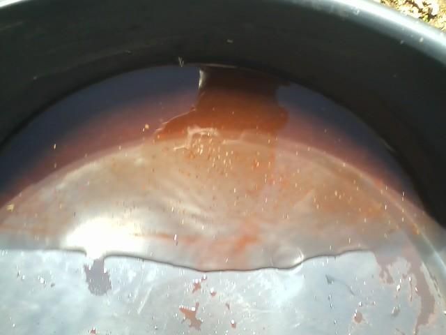

i know the trans leak all the time, im always putting fluid in.

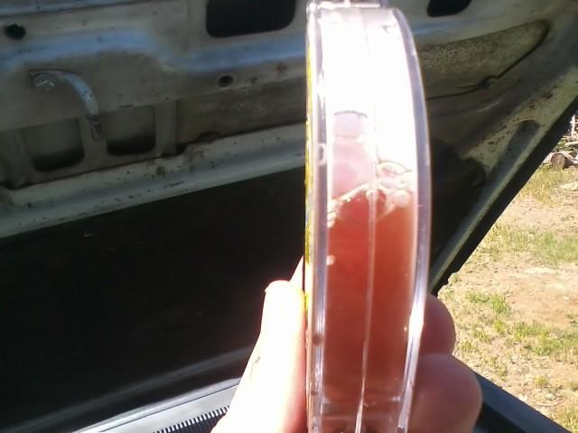

does that look like rust or oil or transmission fluid ?
Take some of the reddish radiator fluid and put it in a glass jar and let it set for a while. If it is trannie fluid, it will slowly separate and rise to the top. If it is rust, it will settle to the bottom. Looks like rust but do this test to be sure.

I asked for a pix of the cap to just be sure it is a pressure type and of the right pressure rating. How did the fluid separate out? Rust (bottom sediment) or oily at the top?

Uh-oh....Is that red oily stuff floating on top of the water in that bucket? Is that from the engine? Looks like trannie fluid......not good. Rad cap at least looks OK for pressure rating'; I kinda feel the same way about the lever types; I don't use them at all anymore.
Time to stop driving the car; looks like the trannie cooler tube in the bottom of the radiator has sprung a leak. You can use a hose to bypass the cooler lines back to themselves (I would do that like TONIGHT to try to limit water into the trannie), but hopefully there is not much water in the trannie. I would be pulling the trannie pan numero uno job to see if there is any water in the bottom, and any indication in the trannie fluid, like discolored foaming or gunky stuff.

^^I meant to suggest, pull a sample after running, fill a glass, and let it sit. Examine for oil on top after awhile^^

That is a great idea and you have alot of good suggestions, how long would it take to separate like you say it will?

Unfortunately, if that is the pix of your coolant in the bucket, the trannie cooler loop in the new rad is apparently defective; I would venture to guees it has a small pinhole in the loop. Hard to say exactly why until it is pulled out and taken apart. Do you have a local rad shop there? Or is this under warranty?
The trannie fluid is pumped under higher pressure than the coolant pressure so it is entering the coolant when running. But, once the car is not running and that trannie pump pressure is gone, there is nothing saying that some rad fluid won't seep back into the trannie cooling line and get carried into the trannie when it gets started again. You'll only know by puling the trannie pan and looking carefully. Once the rad is pulled and fixed for sure, then the flushing of the trannie ought to carry any coolant out of the lines. I would not put in any stop leak; it is not designed to fix a leak like you have in the trannie cooling loop in the radiator.

I don't rightly know; probably not long for oil to start separating, unless there is some additive to make it break up. Looks like the OP's bucket test did not take long.
And if anyone knows what else this orange oily stuff could be that is floating on the water in the bucket picture, now is the time to speak up!
I tend to agree with nm9stheham. The fluid in the bucket looks like trans fluid not rust. I would focus on getting that "new" radiator checked out.
