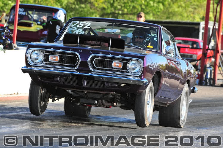

Car Specifications: 360 small block stroked to 408. The block is a 1978 block that I put milodon splayed 4 bolt main caps on the center 3 caps. That step stabilizes the crank and strengthens the block. I also put in hard block water jacket filler to stabilize the cylinder walls. Indy 360-1 cnc cylinder Heads, Indy 1.6 to 1 ratio rockers and shafts.matching Indy intake manifold, Eagle 4340 steel 4" stroke crank, pistons are Probe sportsman racing series flat top pistons with full floating pin. Mahle piston rings.The rods are Scat pro comp series,stock length. Comp Cam gross valve lift .570. Holley HP 830 cfm, MSD ignition 7al-2 with 2 step. 727 trans with B&M reverse manual valve body. Trans brake. TCS 8" 5000 stall converter. Ford 9" diff. 4:56 gears. Strange 33 spline race axle and spool. Competition Engineering 90/10 front shocks. Stock leaf springs rear. Competition Engineering Ladder bars and rotators. Center line wheels. MT tires 28x11.5x15s.It has all new chrome, trim and weatherstripping, Full Stock interior with 5 point roll cage and swing outs for easy in and out access. It has a factory console w/Cheeta Shifter. New this winter are the TTI 1 7/8' headers. Car weight is 3245Lbs.
Dyno tests were done at sea level in Langley British Columbia. Canada. Using Pump gas 94 octane. 611 hp @ 6400 rpm. 545 ft of Torque @ 5000 rpm.
1/4 Mile Times: 11.30 @ 120MPH, 1.574 60 ft
