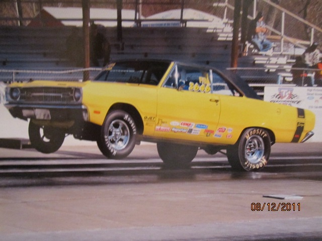

here is my ride .. I restored it myself and worked on just about everything on it mechanically .
best times low 11.0's on motor . stock mopar magnum crate engine 402 cuin.
never had a valvecover or intake off . all bone stock.. never touched .. Just 8 years of tweaking !

Sorry guys ! I was posting all the info on another topic here ... was having so much troubel posting pics I gave up on this post. but I can post some of the goodies done to my dart.
Bought the engine 8 years ago ..... mopar crate magnum stroker 402 cu in. after I restored the dart .
engine specs : sb 360 stroker 4.0 crank . new block >>>new everything.
not a reman engine at all. directly from mopar .
specs 292 -312dur @ 50 , lift 513>>> hyd roller cam.
keithblack pistons
9:1 comp. motor . heads > RT 202 .. bone stock never touched.
m-1 intake never touched.
tried all holleys carbs from 750 up to 950.. the 850 dp made the hp and torque.
headman hustler 1 7/8" fenderwells wrapped .3.5" collector.
exhaust 3" .. the best x-pipe on the market , dynomax muffs and turndowns after muffs.
trans > built by Rush performance all top notch clutchs and bands . 2.0 lever , shift kit , rv manual vb , 3500 turbo action converter , deep pan.
3inch driveshaft with huge joints
frame rails are tied.
8.75 > 3.91 gears
rearsuspension >> caltracs -mono leaf -9 way shocks . all stock location on springs .
front susp. >>>> 6cyl bars . larger 10" front drums & brake shoes
no sway bar . caltrac front shocks,
fuel cell . with big pump , 1/2" fueline
full interior . chromoly 8pt roll bar.
electric moroso water pump, fuel pump and rad fan. taurus
linelock.
custom made sealed air pan to carb .
6pac hood scoop... glass hood and front bumper.
car weighs 3200# W/O driver .
tires are 11.5 hooiser qtps on 7" wide 15" cragers . front center line shinnies 15"
raggie runs in the 11.0's all day on motor, to this day , after some more tweaking last year. it pulls both front wheels off the ground about 4" and carries them out a short distance.
I'm very impressed on what this engine can do... It come a long way in 8 years of tweaking everything.
I am pleased to share all this info with you guys !
Thanks !
