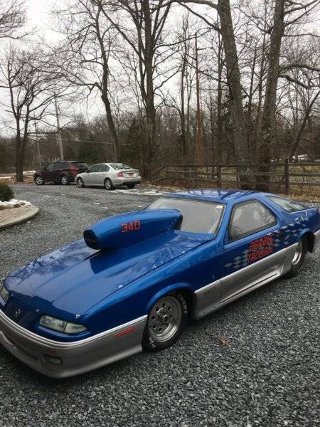

Never say never. My sons stock stroke 360 with 4.10 gears and a non low gear 727 does this.
I bought this like a 1 1/2 yrs ago.

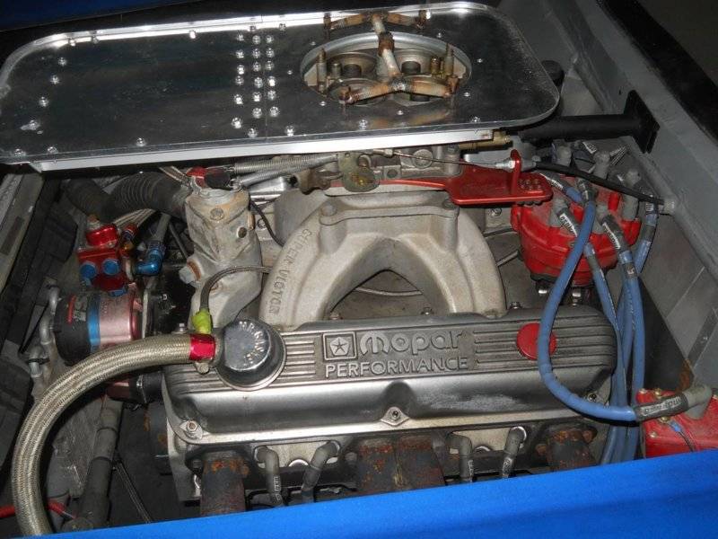

It’s supposed to be a 421, stock block 340 .060 over, 4in stroke with dome pistons and ported Edelbrock Heads, HS rockers. No idea what cam. Super victor with 1050. Transbrake 727 with 4.30 9in.
I went 9.96@141. I think the 60 was only in the 1.50s.

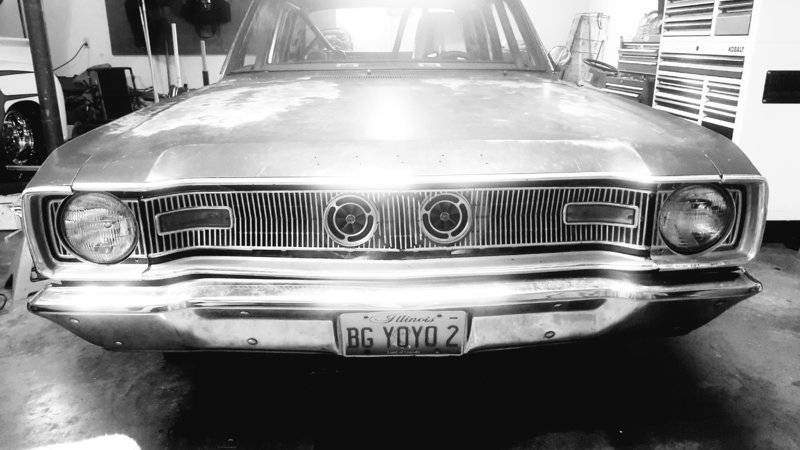

well mine has totally went off the rails this spring and about to wrap it up and be testing in a few weeks.
411" hellcat block and heads(biggas actually)
mmx stroker kit
bfny erik storm custom cam
inconel valve and some light head work
g3 severe duty lifters
twin s475 mm turbos
1.80 reid casd proglide by ptc
9.5" ptc turbo converter
strsnge 9" ultracase 3.70 gear
holley efi and dash
275 pros
cm cage and front half tubular chassis coilovers and k member by hooken chassis race cars in holt mo. home of the fastest small tire cars in the country.
all street car with usable full back seat. shooting for mid 4s in the 1/8th at around 15-1800rwhp

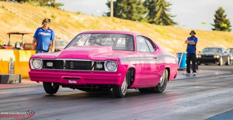

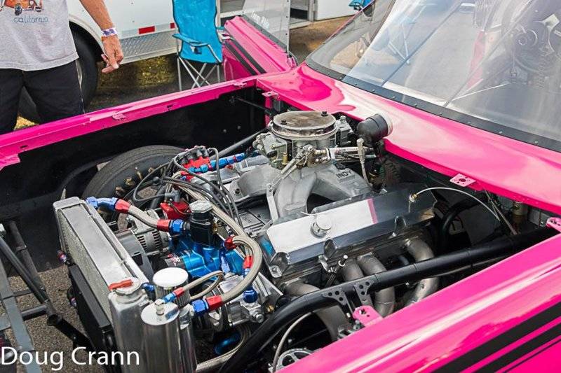

Update."Barbie" Went best 9:22 @ 148 MPH,95 degree's, and 5500' altitude. Our clocks are NHRA altitude adjusted (Super Street class 10:90 is 11:15). We run 3.5-4 tenths quicker at Seattle.Easy 8:80's at 155 at sea level.
All aluminum Indy 540.
-1 heads flow 390
Comp 55 mm roller 775 lift
BLP belt pump
Single AED 1050 dominator on alky
9" PTC custom converter
Billet Randy ray 'glide with 180
7:50 cert Chassis
Fab 9" 4:57's
4 link, locator, anti roll,QA shocks
33.5" T x 17"W x 16" Hoosiers
All steel car (except hood and trunk) 2800+ lbs
All aluminum Indy 540. -1 heads,Comp roller 775 lift,single AED 1050 dominator on alky, all steel car (except hood and trunk) 2800+ lbs
That is down right flying for an all motor car!
