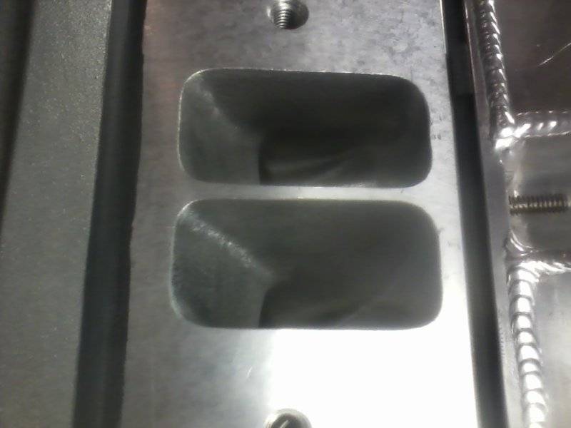

Pulled my intake yesterday to look at my heads and figure out a game plan.
Intake opening appears to be standard 440, at least the same as a 2891 victor intake right out of the box. But the heads are untouched. Feeling pretty good about next season. I'm looking at modern or flow tech 2 to do the port work. Anyone else good with -1s I should be talking to?
And bye bye 4150 intake with my 1250 dominator
I have t&d rockers on mine but those look great! What kind of numbers did you get on your -1s? Is he a member on here or does he have a shop?
He has a shop in Post Falls. Flys under the radar! Not a member here. They flow 383/289 @ 700 lift. About all your going to get without heavily modifying them (welding and changing ports).
I also went to 2.25 valves. He said it would have been better to stay with the 2.19. Just repeating what he said.
When it got down to the end, he scribed them to the block, and went out as far as he could.
