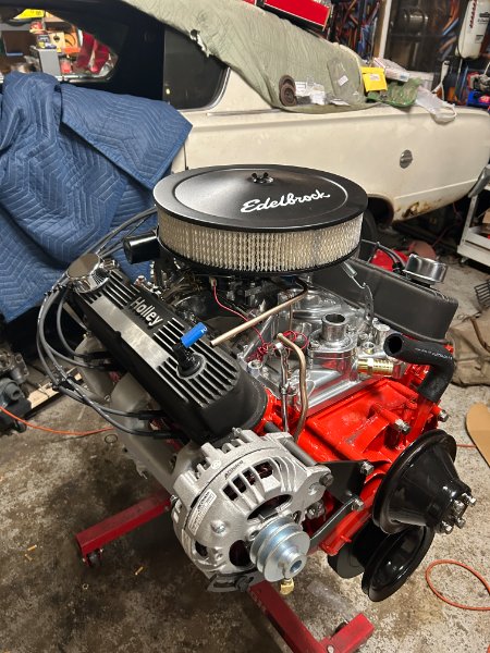

408 w/ Procharger. Hughes Big Mouth Edelbrocks, Hughes rockers, bushed, roller lifters, K1 crank and rods, custom Diamond piston, all forged. 224/228 @.050"
318 +.060 w/ worked SM’s, steel crank, SIR rods, KB’s, CC Magnum rockers, China-Gap, 222-224 @.050
IMM built 416 w/ his Edelbrock job, Pro-Flo EFI, bushed, roller lifters, HS rockers, yada yada

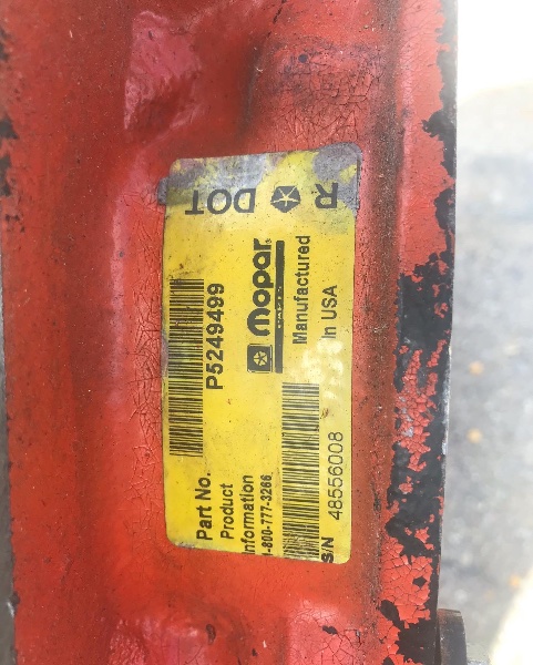

NOS 5.9L Magnum block in its virgin glory. I have a Port-O-Sonic, 3.79" Molnar crank, and Scat rods lined up for it.

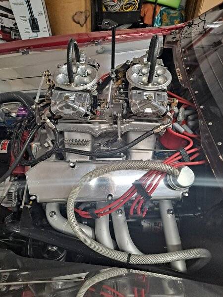

422 stroker. 340 X block. 4.10 bore, 4 inch stroke. CNC ported W5 heads. Holley Pro Dominator tunnel ram with Dominic Thumper massaged Venom VX 850 carbs. MSD 7AL crank trigger ignition, COMP Cams solid roller cam & lifter. Harland Sharp 1.5 rockers. Smith Brothers push rods. 13 to 1 compression. Crank, rod and piston manufacturer unknown right now, but should know soon as engine is currently being disassembled for a refresh. HP and torque unknown but car will be going on a chassis dyno in the spring so I'll have some numbers then.
By the way, I'm going to a single carb setup for this engine. If anyone is interested the tunnel ram, carbs, linkage and 4 port MagnaFuel regulator are available.
