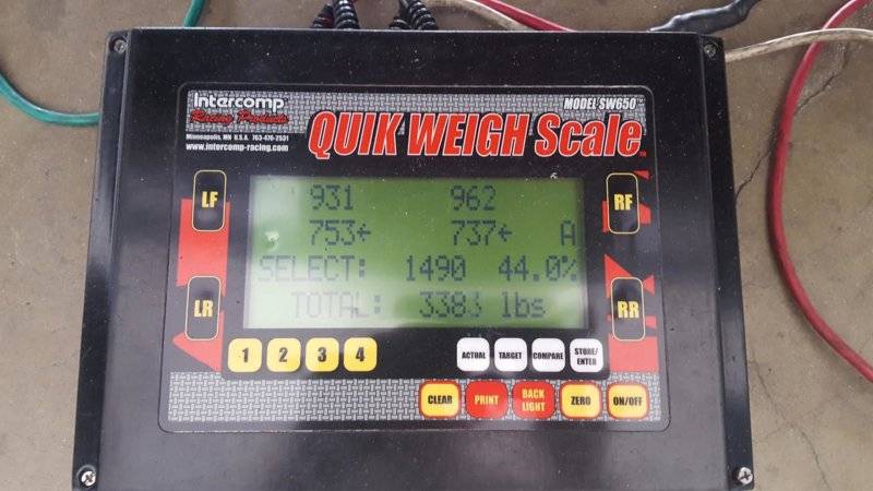

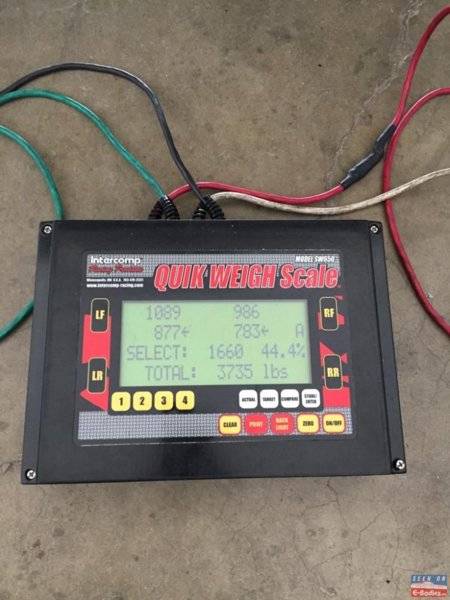

This is Ed Wogulius's 71 Challenger. 340, 4 spd, t/a hood, aluminum heads, cast iron ex manifolds, full interior, no a/c, power steering car..
Last scale reading pic (#3) is with Ed in the car.
That is F/R 56.4%/43.6% weight split w/o driver. (scale is just reading rear percentage)
F/R 55.6%/44.4% weight split w/driver

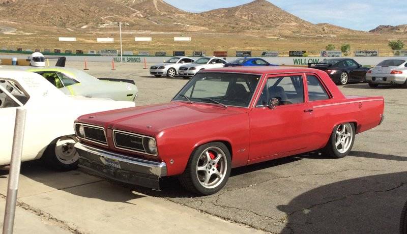

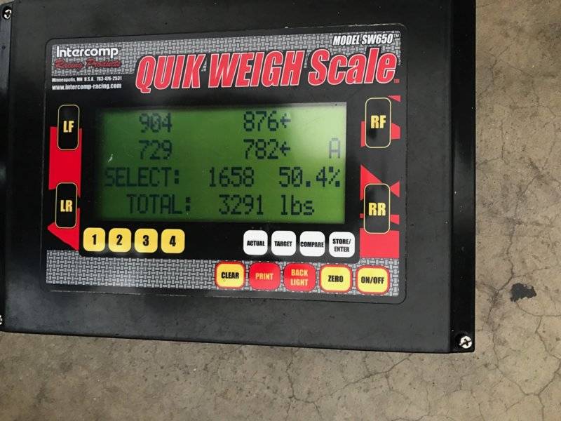

The “Red Brick” built by Tim Werner:
Without driver
With driver
