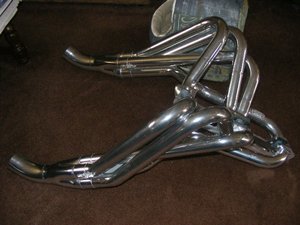

Which headers are you using?

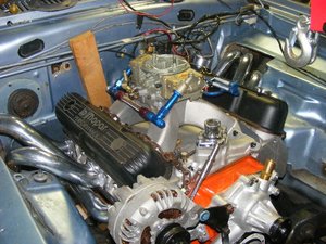

I,m using the Hedman Huslers part# 75110-66 1 7/8 tubes.

I noticed on your 64 vert,that you have your motor mounts on the front of the ears?Supposed to be mounted behind the ears.

Thanks. That may be a bit much for my 273. I was thinking 1 3/4" That will work nicely in your application
Apparently TTI is making step headers now 1 5/8 to 1 3/4.When I started searching for the bigger tube headers,they only made them for W-2 heads.Figures they make the step ones now.Dougs 1 5/8 were like peashooters LOL.
I had TTIs and decided to go fenderwell. Not enough room for chassis clearance. they were a PIA to install and you had to have a starter that clocked.
