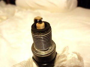

Just seeing what I can change to get better performance/durability from the spark plugs :) They are Autolite 65's with the copper core. And not to long ago my tech instructor told me to trash the Autolites and get Champion because they were designed for Dodge. The whole thing started when he was making fun of a melted Autolite we found in a car haha.
Heres a picture, thanks for any advice.

I've sometimes though about switching to NGK, but the price draws me back some. But I think the topic went a different way then I wanted, I actually wanted to see if I should keep the same plug specs or if something looks wrong? Example, heat range, does it look good?
The color on the electrode is tan (I think) which is perfect, the black outer tells me you're burning a little (I said little) oil and ya Champion ain't what they used to be. I like NGK or Bosch.
The tannish color looks good to me tell your instructor he don't know ****..i wouldn't run champions in a lawn mower...

i'd say you have a tad too much timing in the motor and if that black is soot, fuzzy and rubs off easy, your way rich. if it's oily and shiny then you are have oil intrusion from somewhere. valve guides, intake gasket or rings.
ah, yes ... i too have to chime in...i run champions in my lawn mower only, they suck. ran a high volume shop in florida for 15 yrs. I always used autolite, or ngk. never had a problem with them. the tan color on your electrode looks good, white would be better, but with all the additives in todays gas, tan is all your gonna get. right heat range plug, good air/ fuel mixture settings. leave it alone...

As far as the plug in question it looks like your running rich from the soot on the shell. Could be an overly zealous choke, rich idle, or rich at WOT.
