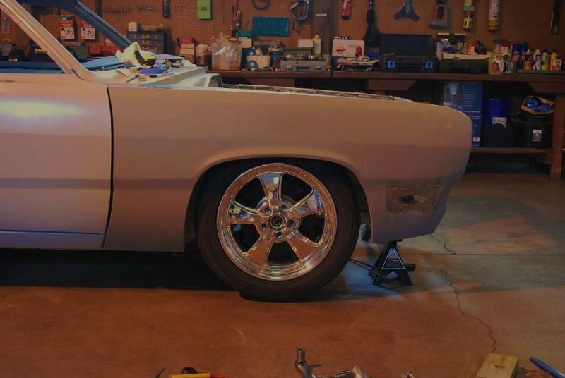

Rearranged some stuff and properly tucked the wheel and snapped another picture at my desired ride height
Remember folk's thats a 20" wheel in that hole and there is plenty clearance after moving the inner fender.
what the ground clearence under the frame rail by the toe board?
are you touching the inner top of the fender right now? if so the the super slammer will work for you
I should be at the same height as Ross at ride height and dropped 2 inches when I let the air out of the bags. I'm resting on the inner fender currently and I will be moving that up 3-4 inches and I'm running a 2" drop spindle as well.

heres my ride height, 100% of the time...no bags, but went with a Wilwood 2" drop spindle 17" rim, 26.5" tire
attachment.php
If I go buy approximate locations in our pictures Ross it appears our spindle is in the same spot on the fender lines. Also our tires seem to end up located in the fender whole at the same spot.
That 20" wheel really fill the wheel well.....should look real low once on the ground
