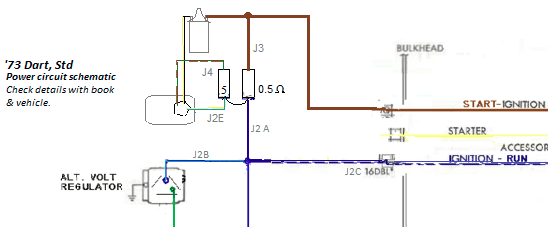

1. Put the key in run and measure voltage at all four terminal postions on the ballast (assuming its factory dual ballast).
If there is a break in either of the ballast. Stop there.
2. With a helper, measure the voltage on the coil side (J3 in drawing below) of the ignition with the key held in Start.
Work in progress. According to the diagram in the service manual, wire J2E in the diagram above that powers the ECU in 1976 comes from a welded splice. That doesn't change the test, just the wires you will observe at the ballast resistor.
