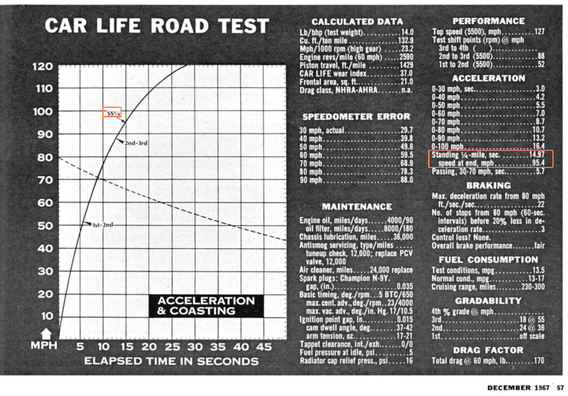

Car Life
'68 Barracuda 340 w/ 727 and 3.23:1 rear, E70-14s. 3840 lbs test wt.
That was probably a pretty honest best run for the test.
Nobody has mentioned gearing. Gearing is going to make a big difference when shooting for E.T in the quarter mile. Also need to think about that when looking at the torque and hp rpm for an engine being built.
