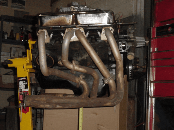

Mark Leshanko made some really nice looking 4 into 1s. Don't know if he's still in business.
He also was making some shorties - there's a FABO thread about it somewhere.
Headers by Ed did it a little differently. Worked great - but hang too low for most street use.
Could it be adapted for a higher ground clearance design? - absolutely.

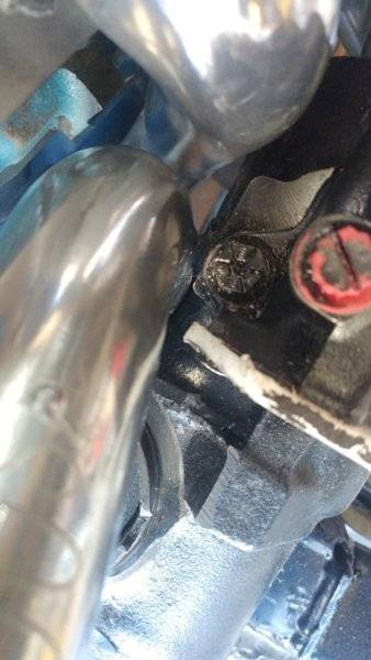

Still hits the steering box here.
Hmmm
How is it that they've been making these headers for years and still haven't revised them to not interfere with the steering?
A body with original 318.
I cut a 1/4" shim to lift up the drivers side, haven't installed it yet so I'm not sure if it will be enough.
Exhaust tube for #3 is a tight bend, why didn't they do the same on #5? It would of fixed this problem. May create a different problem, but I dont think so.

Tti isn't any better in my opinion I had to cut and beat the **** out of them to fit. Not happy. Had them ceramic coated because they said they would fit.
In the process of denting them now, a little more to go.
