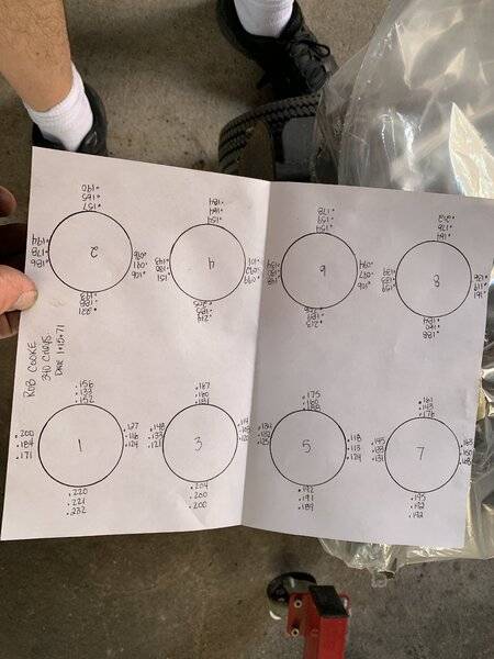

If you bring it to a machinist, have him sonic check it and write it all down. This is really good to know. Try and NOT to bore it larger since thicker is stronger!
Below is the report to a block (or 2) I had checked for wall thickness.
