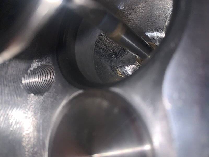

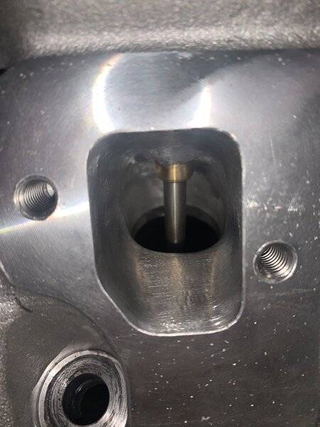

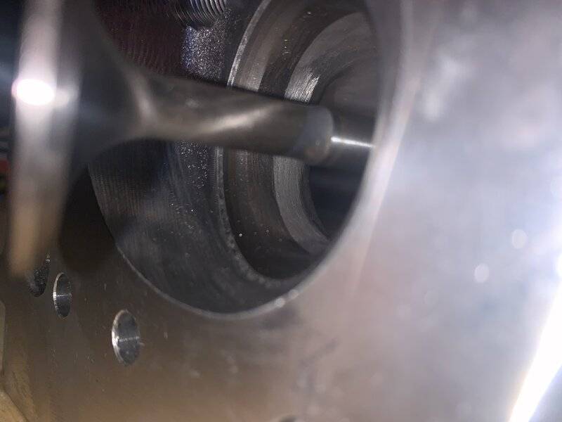

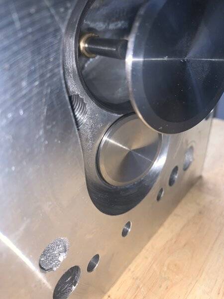

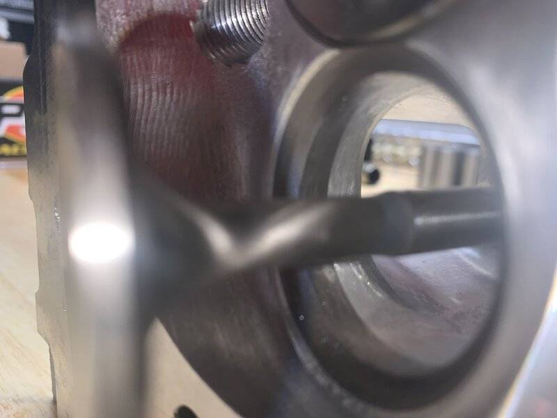

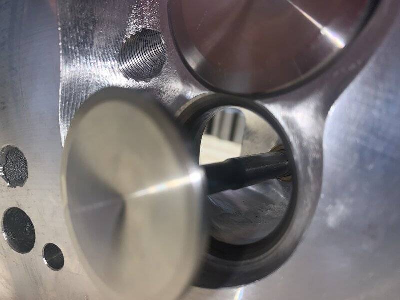

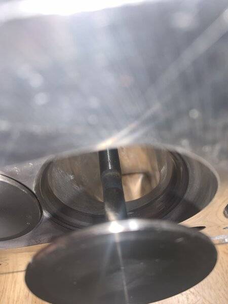

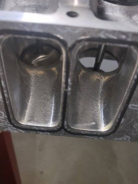

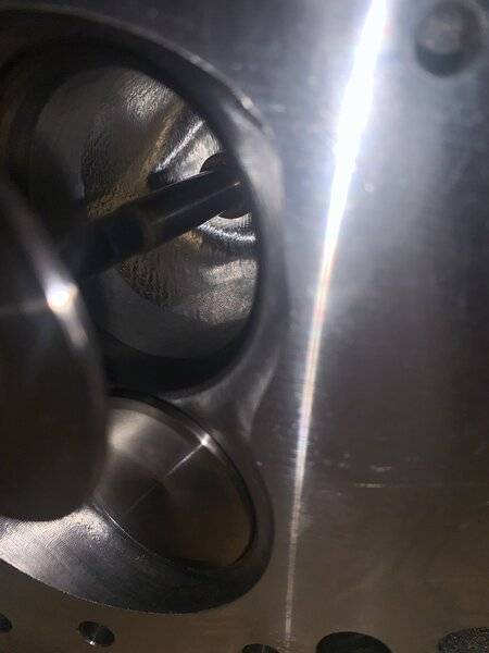

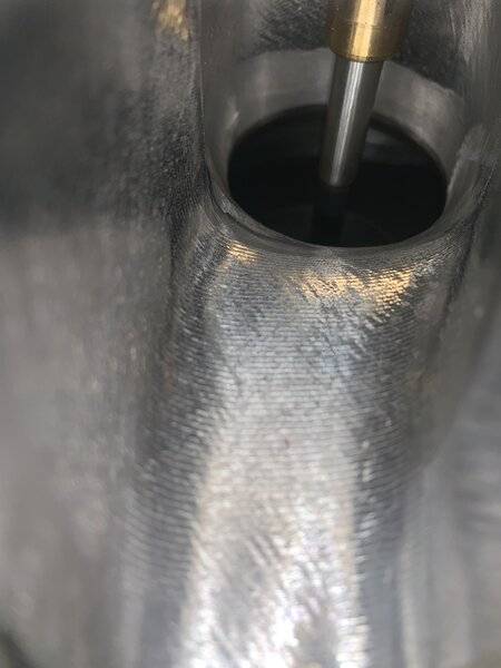

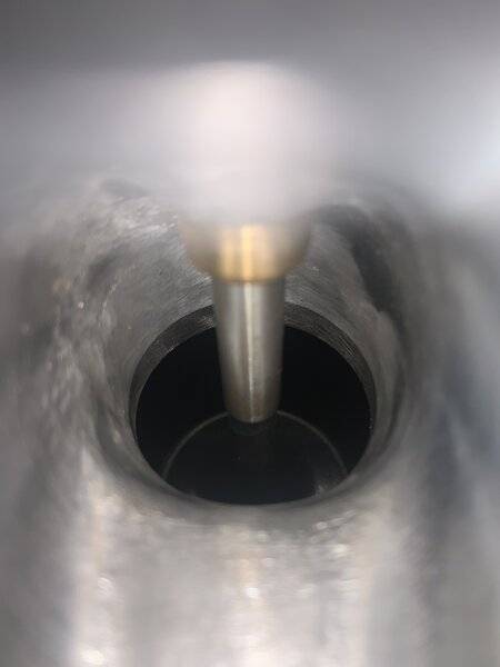

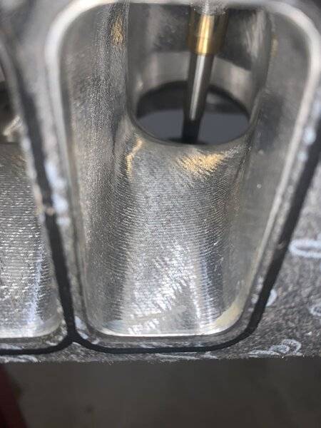

Intake on BM heads;
Good lord! Where is the short turn????
That’s what happens when you have a 170cc runner head and try to make a race head out of it. That why when you see me posting about porting Edelbrock heads or copies I recommend staying away from the floor. I’ll sacrifice some volume for a nicer shortside.

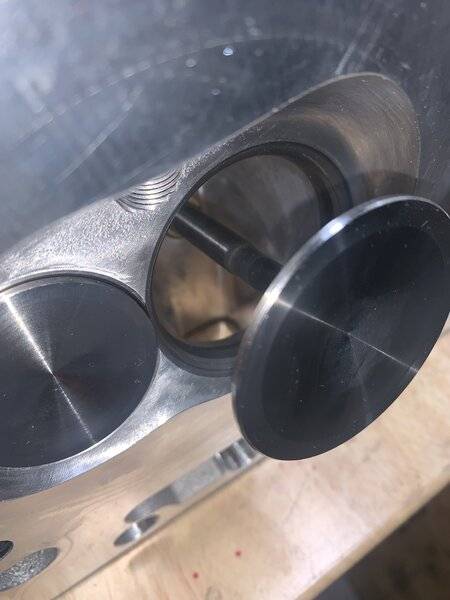

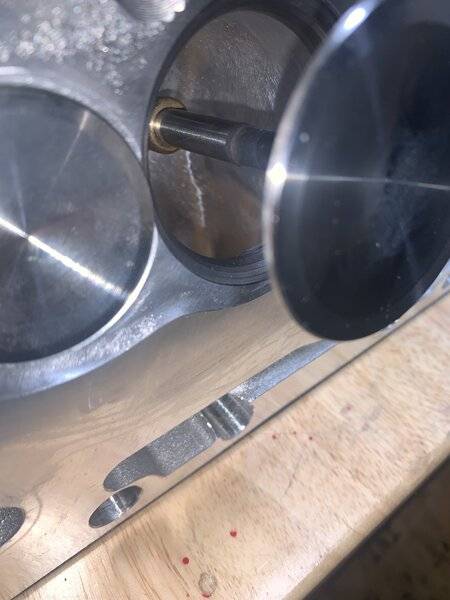

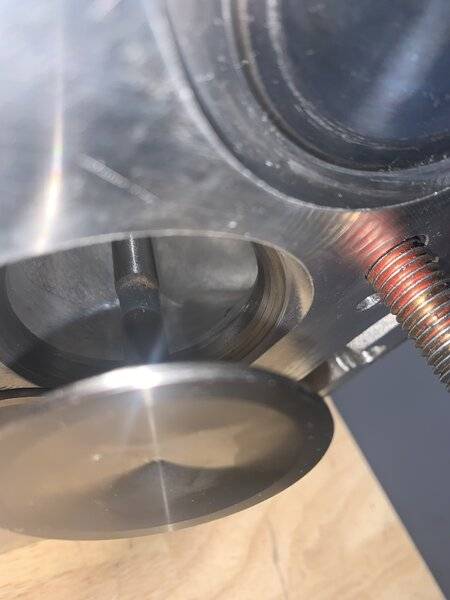

I had a set of Hughes cnc ported SB RPM’s here for freshening a few years ago.
From what I gathered, they were the biggest version, without going to the BM(no offset rocker required).
I was shocked at how flat the floor and SSR were.
Equally surprised that you could take the floor that low without ending up with a hole.
They had 2.08 intake valves, and the chamber was blown out pretty good.
Without digging through my notes, I wanna say the “big number” was in the 280 range.
They sounded very rough on the bench at high lifts as well, but I don’t remember the numbers backing up.
Edit: looked it up
284/201@.700
I’d like to get a BM version on my bench.
