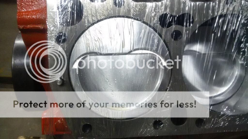

We bought a complete 1978 440 from a wreckers and disassembled it to steal the block.
The block was taken to Competition Automotive in Richmond Hill Ontario. It has been tanked and magna fluxed and everything checks out.
Competition told us that they have not had great luck in the past with 440 source kits and suggest we go with an eagle crank and rods with Wiseco pistons. Stroke will still be 4.25 with a 7.10 rod.
Competition will do all the machine work and assembly. They've done the work on our old 440 and they helped me with the 360 in my Dart.
We are hoping to get it back before Christmas but it's going to be a long wait until we can get back on the track in the spring.

I let the builder, Competition Automotive, source the cam and they talked to Comp. When it comes down to it they decided to use the same cam that was in the 440. Its the Comp 23-770-9 which is .690 Lift and 287 duration @ .050. I figured the RPM range was a bit high being its spec'd at 5000 to 7200. Competition thinks that the lower compression ratio (11:1) will reduce the high end range and work well. We will probably trap around 6500...
This cam was in the 60 over 440 and seemed to work well. I was reluctant to go to a cam with less lift then we had. In actual fact maybe the 440 was a little over cammed.
Time will tell. They are waiting on the pistons to do the final decking.

Well its been a long process due to some health issues with my father but now that has calmed down we got the motor dyno'd this week...
A little back story.... we actually had the engine in the truck and made it to the track. Dad made one pass and lost oil pressure... So we pulled it out and took it back to the builder. They were good and went thru the bottom end. It did take them a while to get it ready to dyno but it's done now. They found no signs of oil loss in the bearings or pump. The only thing they saw was the external oil feed like was slightly loose and may have sucked air and lost prime. It didn't run long without oil pressure.
We had them put it on the dyno only to make sure there were no oil pressure issues. We didn't do any tuning.
So it made 691hp at 6200 RPM and 640 ft.lbs at 5000 RPM. The air fuel showed it was rich so with a small jet change it shouldn't have a problem making 700.
On that one pass dad short shifted 1st and 2nd at 6000 and went thru at close to 7000. The truck went 10.44 @ 128 mph. We are going to borrow a set of 4.30 gear and take out the 4.56 to try to get the RPM's down. The plan is to get back to the track on the 25th.
