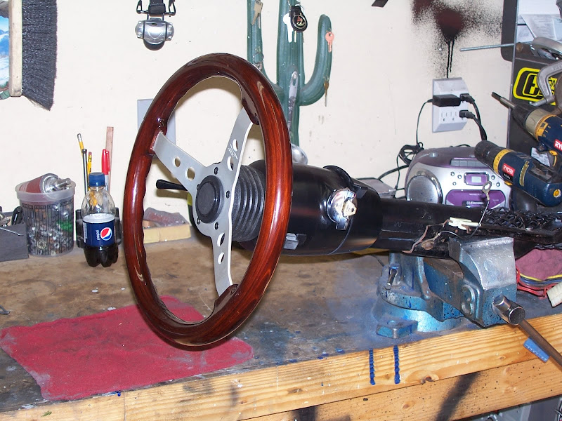

Last week I bought a 71 manual steering floor shift column so today I took it apart cleaned it up. I installed the ignition out of the 74 and painted it. Also rebuilt the shaft coupler and put my steering wheel on it.

8) Great progress on the Dart Stan. Love the steering wheel....Carrera?
