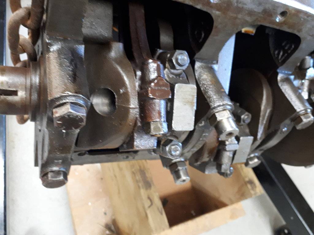

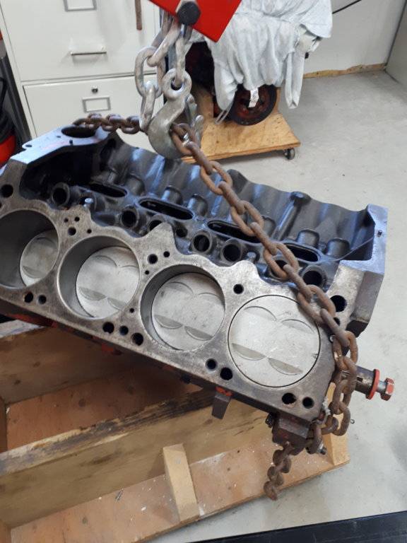

A few years back I bought a 69' 340 short block and buddy threw in a complete low mileage 67' 318 ( never been apart ) . I tucked the two engines under the shop bench as I was busy working on the body of my 70' Dart Swinger . I dragged out the 340 short block today and realized that the pistons have the four valve relief cuts , pistons are recessed in the cylinder at TDC and the crank has the 1/8" parting line . Everything is pointing to a low compression rotating assembly in the 69' block . The flange on the crank is damaged and I knew it was damaged but thinking it was a 69' forged steel crank , I thought it could be repaired and remachined like new . Being a cast crank I think that is now out of the question .

I would start by posting a close-up picture of the parting line on that 340 crank, as well as a picture of the damaged flange you mentioned, so that crank can be evaluated. The "parting line" on a cast crank usually looks like a sharp-ish rough edge and forged crank is wider and smoother. Usually easy to tell by seeing it. As for the 318 cranks, I personally never saw an LA 318 with a forged crank, but some of the older A 318 polysphere headed engines did have it forged. If you have a forged A 318 crank, it's just as good/strong as the 340 forging.

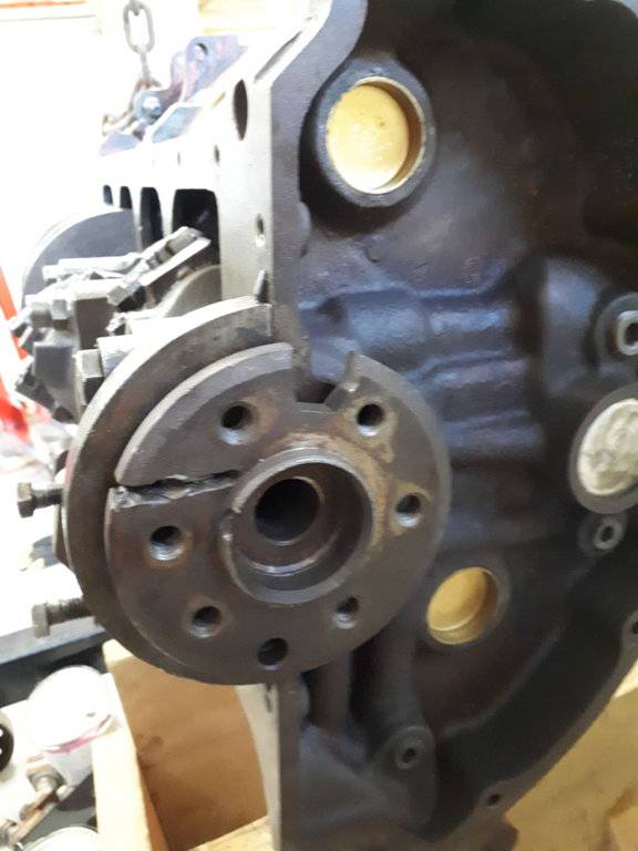

So I checked out the crank this morning and it is a cast crank #3462387 which is late 72' -73' 340 . I did take some pictures but will try to upload them later . The crank flange looks as thou someone had a difficult time removing a flex plate or flywheel . They used a cutting torch ,cutting part way throu the flange between two bolt holes .
The pistons are #3671155 and using a vernier height gage the pistons look to be approx. 65 thousands of an inch below the deck at TDC .
Do you have any pictures of the un-repairable damage?
