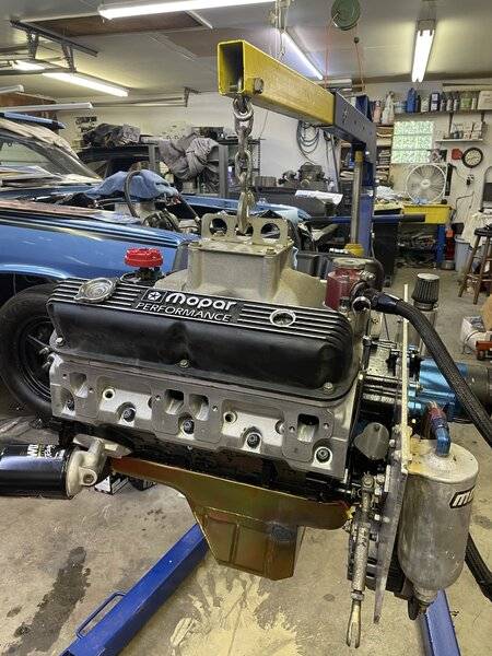

Will my current valve covers edelbrock RPM type, work on the indy cylinder heads?
I run spacers on all of my stuff and my mopar performance once worked on mine. A lot of these covers hit on the better manifolds (super Victor and Victor340) so I run 3/8 valve cover spacers on everything now.
Can you share which spacers I would have to purchase to make them work?

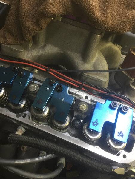

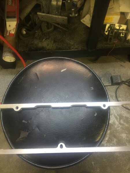

As I’ve told guys before I love these spacers but they are not a bolt on. At least not for me. With the 1.6 rockers I run on about everything I had to grind for pushrod clearance so check this out. Also if you run the fan valve covers I had to slot the holes because those bolts came in at a funky angle especially on my Indy 360-1 heads. Not a hard job but a much easier job to check out on an engine stand.

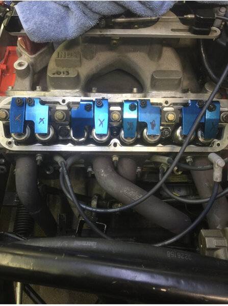

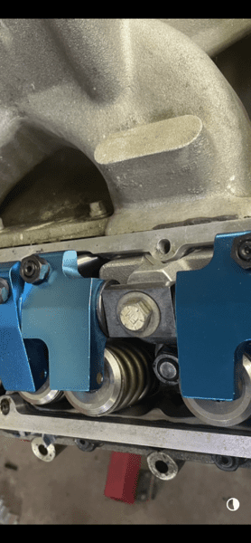

At some point when you have time, could you please post a picture from the intake side, kind of like replicaracer43 did of his head, but showing the clearance you have on that setup between valve cover and intake. I need to order a pair of those but keep putting it off.

I looked back in my gallery and I have a few pictures but nothing that is going to help you. At least on my Indy heads. And that combo won’t be back together till next year. I posted a few of my Edelbrock heads with them
On in my alcohol post last week then o think I deleted my pictures.

Those pictures helped a bunch. I can see how tall it looks next to the intake with that spacer in place. Thanks, I appreciate it.
I saw they make an offset spacer for the Ford small block, moving the cover a little more toward the intake while raising it, but if yours works well with your push rod clearance added I don't need to worry about moving it in, just up.
