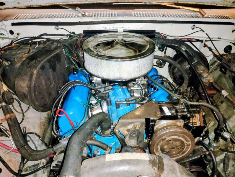

Well, it is a 318. It's a sweetheart. I might have posted these here before. Getting old and forgetful.

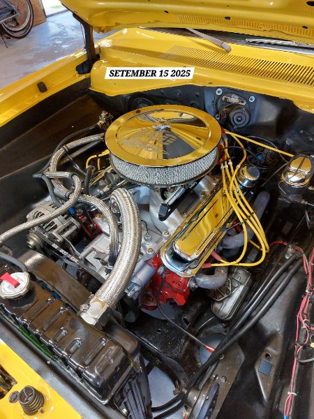

360 Magnum 9.0 cr, 512 lift 220 duration, heads ported out 245 cfm, topped off with a Edelbrock Air Gap and Edelbrock 750. Engine Chrysler Hemi paint provided by por15, Finished in a clear urethane.
360 Roller Engine, Thumbs Up!
You gotta love the 360 roller! budget friendly, roller reliability, more aggressive cam profiles, plenty of good used engines cores available, add all the collective how to performance builds articles out there along with FABO guys who been there done that support, makes for getting one of these engines to sing a very doable goal!
