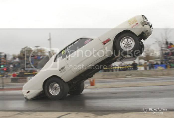

factory small block head castings with some time in them work better than most people can imagine.
Small block in Demon with 587 heads and a .590 Racer Brown flat tappet cam. 1.260 60ft.--6.09 at 111 1/8th mile --9.68 at 136 1/4 mile--No NOS
Go read your first post on this.
You are at best disingenuous. You tried to palm that off as using a 318 casting and that’s a lie.
You can’t grind, shape, port or anything else short of welding (which would be stupid but at this point you like advocating for stupid so there’s always a chance you’d claim welding cast iron is a back yard shop technique) a 318 port to the as cast size of the 340 head.
And it ain’t even CLOSE.
Thanks for making my point. No one seriously tries to make ANY horsepower using 318 casts unless the RULES say you have to.

You do know the 587 casting has a 360 port right? Which is what I said.
Why start with a grind on a 318 head when you can use a 360 head and get a better port without grinding.
You are so disingenuous its sad. You posted a picture of a car that’s not yours (typical) and made the claim he was going fast on 318 heads. And he’s NOT.
You need the help as you are borderline mental. You’re not as smart as you think you are and at best you are a lying poser.
YAWN, more character assassination from the clown who cant address the topic. Stop your hurting my feelings....:rofl:
Those 587's are feeding 410 cubes......Yep we should put them on a 2 barrel 318 because it needs MORE FLOW.
