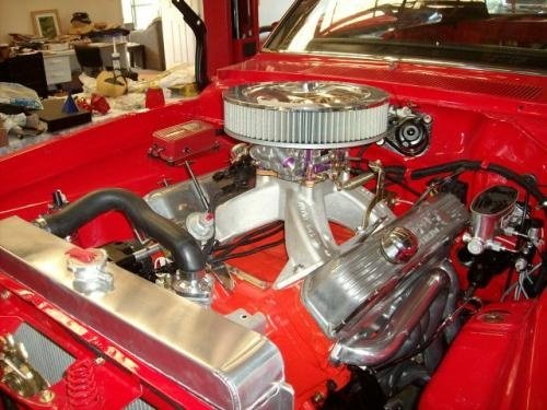

Hi Denny went for my first drive on weekend great your front suspension kit is worth every $ it cost and some car drives great i am running 400lb springs with 12'' (ds501) shocks engine 440 with 906 heads perfect some pic's
