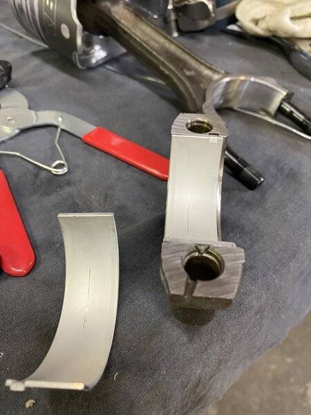

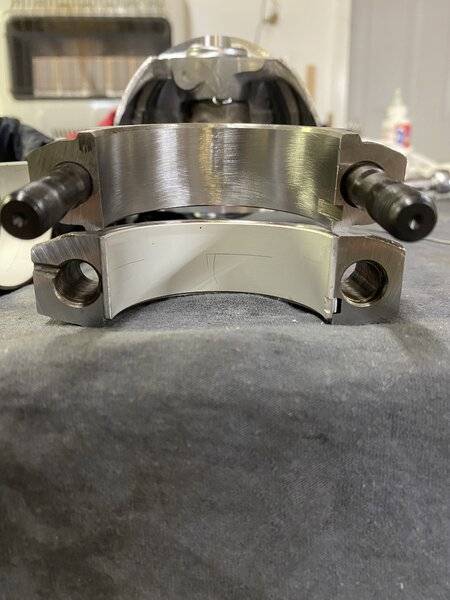

Might have hit a snag and wanted to hear your thoughts. The bearings that I have for the rods do not have the notch for oiling like the rod does. Do I notch them or can I just install them? Or buy new ones?

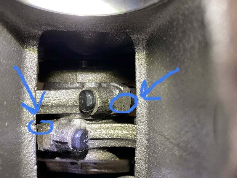

Also I didn’t even catch this until I had 3 pistons installed. The oil notches need to be facing the opposite rod... so is this correct in what it meant?
Some bearings have the oil hole and some don't.
The oil hole on the rod should face the center of the engine or towards the camshaft. They are for splashing oil on the bottom of the cylinders.
I just have an oil slot on the cap. Not on the rod itself. And my picture above of the two rods on the crank is looking down from where the cam would be....
How about my bearings. There’s no notch in them so in conclusion, they will not splash oil to the bottom of the cylinders?
No, those won't. Most aftermarket rods don't have the oil hole any more. Someone figured out it wasn't needed I guess.

Should be ok. I don't think I have seen any aftermarket rods with the oil hole. So, there is hundreds of thousands of HP engines out there without the squirt holes in them.
