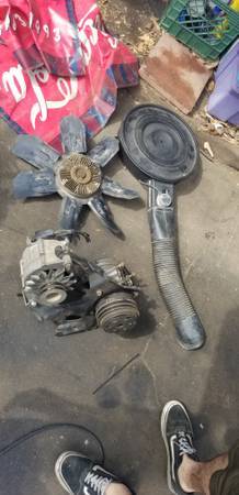

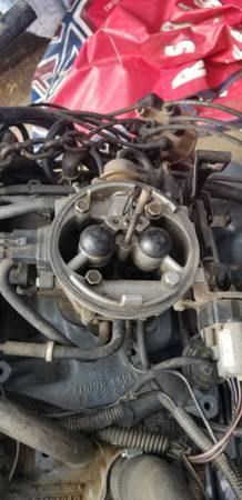

Update. ended up making some money off the TBI fan alt smog pump ac compressor etc. Sold it all for $80.00, guy got a pretty good deal.....
So im at $255.26 now.
