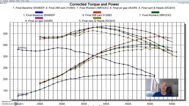

Do a mild hop up on an already installed 318 vs swap in a low power 2 bbl 360, ya that makes no sense lol.
The blue lines Torque and Hp at the bottom of the dyno graph is a stock 2 bbl low cr 360 with manifolds, it show basically zero advantage to the torque (and hp not shown) of the dyno numbers of mild 318 at bottom of the post, xe262h 4bbl and headers.
Make it make sense AJ :)
3-8-Teen Dream
TORQUE SUPERFLOW 901 DYNO-TESTED AT WESTECH
RPMBASEMOD 1MOD 2
2,000292
2,500287
3,000287338336
3,500272335340
4,000248326330
4500218309319
5,000188285296
5,500250258
