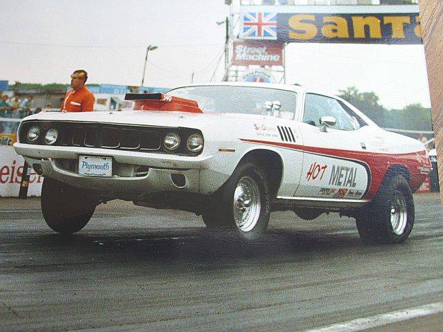

My Street/strip '71 Cuda 340>
Weight @the line, approx 3580lbs, all steel car.
Engine:- '71 stock 340 block/pistons/2.02 heads+
DC. .590 solid, Holley Strip Dominator intake+2" open spacer, 850DP
MSD6A, NGK 6's
1.3/4" Hedman Race hdrs.
Around 9.8:1CR
727, fmvb, T/A 4200 stall
Stock 8.3/4", posi, 4.30's
Susp:- Stock L/springs, clamped@front, Long Shocks+snubber
Stock front with std worn shocks
Front runners, 10x28 G/years.
best:- 11.01@122.5 w/150hp N20
In 1986.

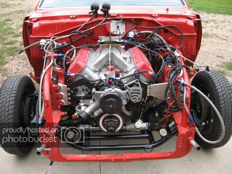

727 trans with adapter plate, k frame needed to be notched but I have since gone tubular k frame, I had to build the headers, crank adapter, motor mounts, its a lot of work and if I had to do it over I would just build a nice big block, but there is a neat factor in having a nascar motor in a street car, it is definitely fun, and the dry sump oiling kicks ***,

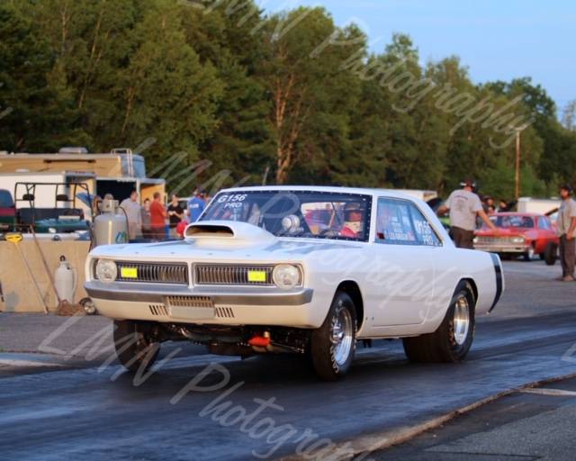

1972 Dodge Dart.
360 block bored .070 over. 1/2 filled with hard block for strength.
Custom offset ground crank.
6" small journal SBC rods.
Ross custom pistons, 13.8 to 1 compression.
W2 race ported heads with Manley 2.08 int, 1.65 exh valves
K-motion springs.
Competition Cams full roller cam .646 lift.
Competition Cams pushrods.
Norris stainless steel roller rockers.
Victor intake with single Holley 1050 Dominator jetted .99 all 4 corners.
MSD 7AL ignition box, with MSD crank trigger firing MSD distributor.
Hedman Hussler 2" headers.
LT race 727 Torqueflite with Cheetah reverse pattern manual valve body, Turbo Action 4400 converter
Dana 60 with 5.13 Richmond Pro Gear, Strange axles and spool.
Alston Ladder bar rear suspension with Comp Engineering coil over shocks. Stock front suspension with exception steering has been converted to rack & pinion. Unknown front shocks.
Full cage that has previously been certified to 8.50.
Converter has tightened up and isn't flashing to 4400, will address that issue during the off-season. Best ET to date
is a 10.54. Expect to pick up a few tenths when converter is rehabbed.

What size slick is on the car? Can we get some more pics of the car too.
32×14×15
I will take more photos at the track this Sunday and post them.
Car was originally built by a gentleman from Long Island and was a big block 9 second car. Still has the parachute mount and actuation cable from those days.
